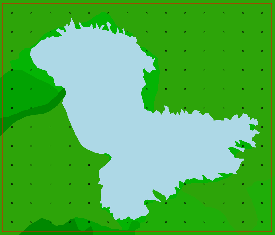

The image attached is a screen capture from the Map Display. There is a category
raster (green regions) with a gap (lake Chad) that must be filled with the
nearest neighbour category. The strategy is to create a points vector from the raster
and then apply v.surf.idw with npoints=1.
If the density of points is too high (> 10 000) the module fails with the
message “Killed”. With fewer points the module fails with the message
“ERROR: No points found”. Below is a log with an example. I have
tried many different combinations of resolution and number of points, I also tried different mapsets, SQLite and Postgres back-ends, but the result is always the same.
What can be going wrong?

GRASS 7.8.2 (S4AHomolosine):~ > g.region nsres=20000 ewres=20000 w=1474000 n=1626000 e=1760000 s=1383000
GRASS 7.8.2 (S4AHomolosine):~ > r.to.vect type=point input=soil_map_rcl_no_water output=soil_map_rcl_no_water --overwrite

Dear Luis,
Thanks for your feedback!
If you didn’t provide a column name, and the module didn’t fall back to the cat column as it is supposed to, please report it as a bug (ideally with a reproducible example). According to the manual and my very little understanding of the c code, it should.
All the best,
Vero
El lun, 19 abr 2021 a las 16:00, Luí­s Moreira de Sousa (<luis.de.sousa@protonmail.ch>) escribió:
Hi Vero,
from what I understand the module is seeking neither the value column, not the cat column. This map was created with r.to.vect, these are its attributes:
v.info -c soil_map_rcl_no_water
Displaying column types/names for database connection of layer <1>:
INTEGER|cat
INTEGER|value
CHARACTER|label
If v.surf.idw was indeed seeking the cat column I would expect the module to succeed with this input, producing a nice Voronoi map.
My suggestion would be to explicitly reference the name of the default column/attribute in the manual.
Thank you.

On Monday, April 19, 2021 1:56 PM, Veronica Andreo <veroandreo@gmail.com> wrote:
Dear Luis,
El lun, 19 abr 2021 a las 8:45, Luí­s Moreira de Sousa via grass-user (<grass-user@lists.osgeo.org>) escribió:
Dear Anna,
thank you for the reply, indeed once I added the column parameter the module completed successfully. The manual includes the following on this parameter:
column=name
Name of attribute column with values to interpolate
If not given and input is 2D vector map then category values are used. If input is 3D vector
map then z-coordinates are used.
If I read that correctly, the module should pick up the “value” column by defualt. This particular layer was created by GRASS itself and includes a “value” column:
I might be biased, but the description is clear to me: provide the name of a column that contains the values/quantities that will be used to interpolate. If you do not provide a column name, cat will be used (i.e., the IDs) in a 2D vector, or the z column in a 3D vector.
INTEGER|cat
INTEGER|value
CHARACTER|label
It is now clear this is not the case, v.surf.idw is seeking another column by default, one that is not created by vector creating modules.
It does not seek for another column, it defaults to cat if you do not provide a column name where the variable you want to interpolate is. It would be annoying, IMO, if I was forced to name a column value just because a module only takes that name. Also, there might be many columns with quantities/values in the attr table of a vector. How is the module supposed to know which one to use, if the user does not provide a name?
Perhaps this could be made more explicit in the manual page.
Maybe the fact that value appears in the description and your column is called value triggered the confusion?
We really appreciate any suggestions on how to improve the wording to make it clearer.

Dear all,
I opened a new issue with a simple example:
https://github.com/OSGeo/grass/issues/1547
Thank you for the replies.
Luís
Sent with ProtonMail Secure Email.

Dear Luís,
On Wed, Apr 21, 2021 at 8:47 AM Luí­s Moreira de Sousa via grass-user
<grass-user@lists.osgeo.org> wrote:
Dear all,
Anna has fixed the issue.
It has also been backported to the upcoming GRASS GIS 7.8.6.
Best,
Markus
