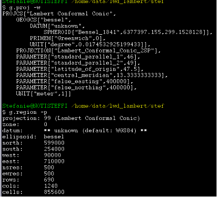

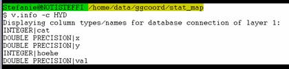

what can I do to import and project my map with geographic projection in
another location of as in my case Austria lambert projection?
v.proj loses every information (the whole content of the attribute table).
I would appreciate your help!

Stefanie,
(have received offlist the location)
I have tried with GRASS 6.4.svn on Linux, no problem:
GRASS 6.4.svn (lwd_lambert):/tmp > v.proj HYD loc=ggcoord map=stat_map

GRASS 6.4.svn (lwd_lambert):/tmp > v.db.select HYD
cat|x|y|hoehe|val
1|10.542778|47.369722|960|-1.2
When you run v.proj as indicated above, the v.db.select command
won't show all the attributes as here?
I suppose you use 6.3.0 Cygwin-GRASS, right (I forgot).
Is there any other Cygwin-GRASS who could make this test?
Markus
