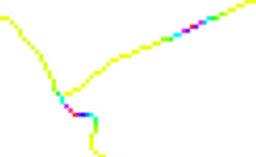

Hello ps.maps experts!
I include a rastermap in ps.maps via:
raster raster_map
it seems that the resolution/quality properties how the rastermap
is included is very low or any smoothing filter is used. I just want
really sharp raster cells instead of kind of fuzzy ones (see attached picture). Is that somehow possible to change that?
/johannes
raster raster_map
The blurring has nothing to do with ps.map. It's caused by the
rendering of the resulting PostScript file.
To avoid it, ensure that anti-aliasing is disabled in whichever
program you're using to render the PostScript.

Oh thank you Glynn, I didn't thought about that option that it is a
rendering issue of the PostScript. It is just a setting issue in the
postscript viewer :slight_smile:
/j
