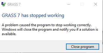

I am a student from India. I am using GRASS GIS 7.2.2 as a standalone in Windows 10 operating system.
My aim is to use r.horizon module to calculate horizon at a point in my study area and save it to a .csv file. As I run the following command in the console window on GRASS GIS:
r.horizon -d --overwrite elevation=n34_e077_1arc_v3@PERMANENT direction=90 step=22.5 coordinates=741302,3793829 file=C:\Users\user\horizon.csv
But I am receiving an error message as attached herewith. Earlier also I got the same error message but at that time it was due to non-alignment of my DEM.

Please help
my DEM.

Could you set
g.gisenv set="DEBUG=3"
before you run the module on your own data and report the debug output
best regards
Helmut
Sent from: http://osgeo-org.1560.x6.nabble.com/Grass-Users-f3884509.html
Dear sir,
Thanks for your quick response.
Here is my output:
g.gisenv set=DEBUG=3
(Wed Mar 07 18:42:35 2018) Command finished (0 sec)
(Wed Mar 07 18:42:55 2018)
r.horizon -d --overwrite elevation=n34_e077_1arc_v3 direction=90 step=22.5 coordinates=741286,3793821 file=horizon.csv

On Wed, Mar 7, 2018 at 6:42 PM, Helmut Kudrnovsky <hellik@web.de> wrote:
Johnn Wani wrote
Dear sir,
Thanks for your response.
I tried with NC sample dataset and it worked fine.
Regards
John
On Wed, Mar 7, 2018 at 4:23 PM, Helmut Kudrnovsky <
hellik@
> wrote:
Johnn Wani wrote
Dear GRASS GIS users,
in
in
direction=90
I
of
my DEM.
This time my DEM is aligned, here is the output of g.region -p command:
g.region -p
projection: 3 (Latitude-Longitude)
zone: 0
datum: wgs84
ellipsoid: wgs84
north: 35:00:00.5N
south: 33:59:59.5N
west: 76:59:59.5E
east: 78:00:00.5E
nsres: 0:00:01
ewres: 0:00:01
rows: 3601
cols: 3601
cells: 12967201
(Wed Mar 07 15:15:14 2018) Command finished (0 sec)
have you tried the example with the NC sample data set mentioned in the
manual?
best regards
Helmut
grass-user mailing list
grass-user@.osgeo
https://lists.osgeo.org/mailman/listinfo/grass
Could you set
g.gisenv set=“DEBUG=3”
best regards
Helmut
grass-user@lists.osgeo.org
https://lists.osgeo.org/mailman/listinfo/grass-user

Dear sir,
As I run the r.horizon module on a DEM with the projected coordinate system. It works fine.
Thanks

D1/3: calculate() starts…
(Wed Mar 07 18:43:01 2018) Command finished (6 sec)

from the manual [1]
At the moment the elevation and maximum distance must be measured in meters,
even if you use geographical coordinates (longitude/latitude). If your
projection is based on distance (easting and northing), these too must be in
meters. The buffer parameters must be in the same units as the raster
coordinates (e.g., for latitude-longitude locations buffers are measured in
degree unit)
your first report was a module run within a latlon location; check the
buffer option is in the right unit
[1] https://grass.osgeo.org/grass72/manuals/r.horizon.html
