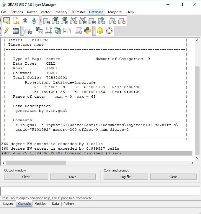

Hello Vero,
Thanks a lot for your response.
I have tried that with no results, with the error in the image bellow:
(attachments)

It is a bit difficult to read, can you post the command you used? It seems you typed image twice, suffic instead of suffix and you are using $() to pass the list of map names which is not necesary, AFAIU. Try the following:
i.nightlights.intercalibration image=img1,img2,img3 suffix=c model=liu2012
if that does not work, then, Nikos will know :wink:

Hello Veronica,
Thanks a lot it worked!!
following the line you wrote:
i.nightlights.intercalibration image=img1,img2,img3 suffix=c elvidge2014
and got the error:
(Thu Jun 21 17:36:56 2018)
i.nightlights.intercalibration image=F101992,F101993,F101994,F121994,F121995,F121996,F121997,F121998,F121999,F141997,F141998,F141999,F142000,F142001,F142002,F142003,F152000,F152001,F152002,F152003,F152004,F152005,F152006,F152007,F162004,F162005,F162006,F162007,F162008,F162009,F182010,F182011,F182012,F182013 suffix=c model=elvidge2014
i Inter-satellite calibration of DMSP-OLS Nighttime Stable Lights
WARNING: Operating on current region
Calibrating average visible Digital Number values
Regression coefficients: (-2.057, 1.5903, -0.009) | Associated R^2: 0.9075
360 degree EW extent is exceeded by 0.999827 cells
ERROR:
  • Timestamp is missing! Please add one to the input map if further times series analysis is important. If you don’t need it, you may use the -t flag.
    (Thu Jun 21 17:37:47 2018) Command finished (51 sec)
    (Thu Jun 21 17:39:49 2018)
So aggregating the flag -t, because an error that appeared, as follows:
i.nightlights.intercalibration image=F101992,F101993,F101994,F121994,F121995,F121996,F121997,F121998,F121999,F141997,F141998,F141999,F142000,F142001,F142002,F142003,F152000,F152001,F152002,F152003,F152004,F152005,F152006,F152007,F162004,F162005,F162006,F162007,F162008,F162009,F182010,F182011,F182012,F182013 suffix=c model=elvidge2014 -t
And it finally worked!!
But as you can see bellow all inter-calibrated layers were created but F182013 was not generate (F182013.c)
if you see at the end of this email it shows an error for the last layer F182013 of the data set…
Why could this be happening?
Thanks a lot again.
Gabriel
WARNING: As requested, timestamp transferring not attempted.
Regression coefficients: (0.8261, 1.279, -0.0041) | Associated R^2: 0.9387
Regression coefficients: (1.3606, 1.2974, -0.0045) | Associated R^2: 0.9013
Regression coefficients: (0.2853, 1.1955, -0.0034) | Associated R^2: 0.9039
Regression coefficients: (-0.0001, 1.4159, -0.0063) | Associated R^2: 0.939
Regression coefficients: (0.1065, 1.1371, -0.0016) | Associated R^2: 0.9199
Regression coefficients: (0.6394, 0.9114, 0.0014) | Associated R^2: 0.9511
Regression coefficients: (0.5564, 0.9931, 0.0) | Associated R^2: 0.945
Regression coefficients: (0.9492, 1.0683, -0.0016) | Associated R^2: 0.8918
Regression coefficients: (2.343, 0.5102, 0.0065) | Associated R^2: 0.8462
Regression coefficients: (1.8956, 0.7345, 0.003) | Associated R^2: 0.9095
Regression coefficients: (1.875, 0.6203, 0.0052) | Associated R^2: 0.9392
WARNING: No data base element files found
Traceback (most recent call last):
File “C:\Users\Gabriel\AppData\Roaming\GRASS7\addons/scrip
ts/i.nightlights.intercalibration.py”, line 525, in
sys.exit(main())
ts/i.nightlights.intercalibration.py”, line 340, in main
model_parameters = retrieve_model_parameters(Model,
*args)
ts/i.nightlights.intercalibration.py”, line 242, in
model = model_class(*args, **kwargs)
File “C:\Users\Gabriel\AppData\Roaming\GRASS7\addons\etc\i
.nightlights.intercalibration\intercalibration_models.py”,
line 155, in init
CalibrationModel.init(self, author, satellite, year)
line 43, in init
year=self.year)
line 67, in verify_year
raise ValueError('The selected model does not know about
ValueError: The selected model does not know about this
combination of Satellite + Year!
(Thu Jun 21 18:08:00 2018) Command finished (28 min 10 sec)

* Gabriel Cotlier <gabiklm01@gmail.com> [2018-06-21 18:24:38 -0300]:
Hello Veronica,
Dear Gabriel,
Thanks for posting details and great it works. Don't worry about the
last image, there are no coefficients for F18 and 2013. We are forced
to skip this image in any analysis.
Details
Veronica is right, and I am ignorant for so many things when it comes to Windows.
In Linux, one may use the syntax `some_command` or
$(some_command). It's a smart way to feed-in longer list of items, such
as map names in GRASS GIS. Note, the former is old-style, so best to use the $()
notation (if of interest, see
https://unix.stackexchange.com/a/5782/13011).
You might want to re-check the extent you have set, so as to
get rid of the "360 degree EW extent is exceeded by 0.999827 cells"
messages (?). Depending on how you have set your region, maybe the `-a`
option for `g.region` would help (?).
The last failing image is not a computational error. The error
message
means that there are no coefficients for satellite "F18" and for the
get rid of the “360 degree EW extent is exceeded by 0.999827 cells”
messages (?). Depending on how you have set your region, maybe the -a
option for g.region would help (?).

Hi Gabriel,
What you could do is import with r.in.gdal -a that adjusts resolution for lat long maps [0] and then (before the intercalibration step), set the region to one of the imported maps with g.region raster=yourmap
HTH,
Vero
[0] https://grass.osgeo.org/grass74/manuals/r.in.gdal.html

In my case I’m using GRASS 7.4.0 in Windows 10, and when I called for metadata info of the layer I got the message bellow with the problem highlighted in yellow bellow.
What could be happening? It would be very helpful to understand what is happening and how to solve importing many raster layers without this extent problems.
I appreciate your help.
Thanks a lot in advance.

(Mon Jun 25 00:30:03 2018)
r.info map=F101992@PERMANENT

On Mon, Jun 25, 2018 at 5:40 AM, Gabriel Cotlier <gabiklm01@gmail.com> wrote:
Hello,
I think I have found a similar situation solved for Linux version at:
https://trac.osgeo.org/grass/ticket/2757#comment:21
The resolution is a bit wrong, it is 0.008333333300000 but should be 0.008333333333333, i.e. exactly 30 arc-seconds. This can be solved with the -a flag of r.in.gdal, or after import with r.region -a.
The message
will change to
360 degree EW extent is exceeded by 1 cells
but will not go away, because 360 degree EW extent is exceeded in the input data, the first and last column cover the same geographical area. You can change your current region to chop of e.g. the first column: set the region to the raster, then modify the current region with g.region w=179:59:45W -p and use this region for further processing.
Markus M

Dear Markus,
Thanks a lot for the explanation.
After importing the layer F101992 I did :
r.region -a map=F101992@PERMANENT
and I got the results as you indicated, with the new resolution message:
Nonetheless, the message of the old resolution (360 degree EW extent is exceeded by 0.999827 cells) still appear but in the second line of the message bellow:
Could be this indicating it changed from old to new resolution?
Thanks a lot again for your help.
The message
will change to
Markus M

On Mon, Jun 25, 2018 at 4:33 PM, Gabriel Cotlier <gabiklm01@gmail.com> wrote:
Dear Markus,
Have you adjusted the current region to match the adjusted raster with
g.region -p raster=F101992
After that, the first or last column could be ignored in further processing by setting the region as I suggested before.
Markus M

* Markus Metz <markus.metz.giswork@gmail.com> [2018-06-25 08:29:45 +0200]:
The message
will change to
I guess this is worth being documented in the manual of the add-on. Would
it also make sense to let the module attempt to perform this "correction"?
Nikos
On Tue, Jun 26, 2018 at 9:53 AM, Nikos Alexandris <nik@nikosalexandris.net> wrote:
The message
will change to
This is a universal problem applying to various raster data in latlong. The first issue, 30 sec represented as 0.008333333300000 instead of 0.008333333333333 is solved by r.in.gdal -a. The second problem, this extra column responsible that 360 degree EW extent is exceeded by 1 cell can be solved by setting the current region accordingly. This is also a universal problem. Maybe the manual of r.in.gdal could include a hint about how to do this. Generally, users are encouraged to inspect the output of r.info after importing raster data to check if everything is as expected.
Would
it also make sense to let the module attempt to perform this “correction”?
If you refer to i.nightlights.intercalibration, I would say no, because it is a more general issue not restricted to DMSP-OLS nightlight data. Even more general, the current region as set by the user is used for raster processing (with a very few exceptions).
Markus M

- https://gis.stackexchange.com/a/243050/5256
Would
Yes, I refer to it. Understood, I won't touch upon this within the
module.
Nikos
