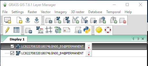

3.started grass gis and d.rast for displaying the already automatically loaded Band 4
  1. import with r.in.gdal Band 5 using Band 5 complete name as was Band 4 loaded “LC82270832018074LGN00_B5”

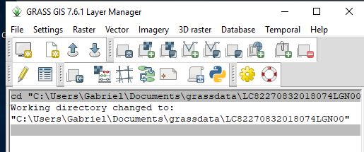

  1. I changed working directory to where the data is:

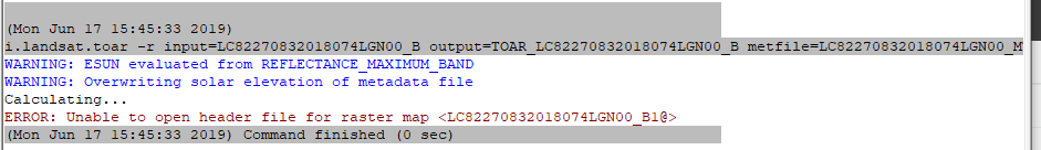

  1. in command line (the withe one in grass interface) I tried to i.landsat.toar for obtaining TOA Radiance as follows :
i.landsat.toar -r input=LC82270832018074LGN00_B output=TOAR_LC82270832018074LGN00_B metfile=LC82270832018074LGN00_MTL.txt sensor=oli8 date=2018-03-15 sun_elevation=45.06637424 product_date=2018-03-20
and the resulting error was:
I do not really understand what could be happening related to the bands names?

Seems to me that the module needs all Landsat bands. Try importing all of them

Indeed it needs ALL bands.
I used this module in class a couple of weeks ago. You need to import and use all bands, including the panchromatic.
