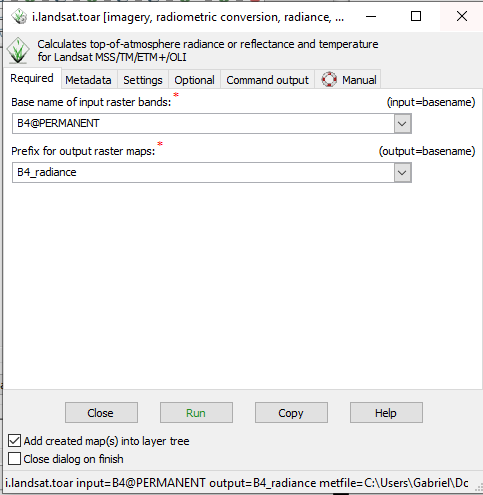

I enter the data band

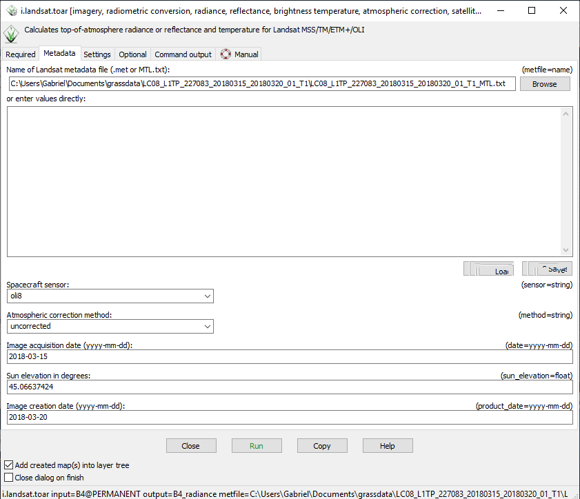

I entered the metadata

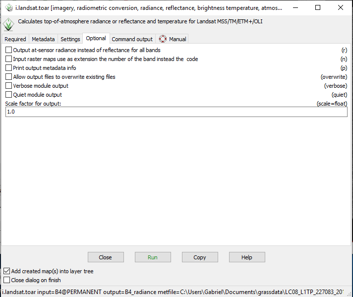

I left these two following tabs as default settings

i.landsat.toar input=B4@PERMANENT output=B4_radiance metfile=C:\Users\Gabriel\Documents\grassdata\LC08_L1TP_227083_20180315_20180320_01_T1\LC08_L1TP_227083_20180315_20180320_01_T1_MTL.txt sensor=oli8 date=2018-03-15 sun_elevation=45.06637424 product_date=2018-03-20
WARNING: ESUN evaluated from REFLECTANCE_MAXIMUM_BAND
WARNING: Overwriting solar elevation of metadata file
Calculating…
ERROR: Unable to open header file for raster map <B4@PERMANENT1@>
(Fri Jun 14 10:52:44 2019) Command finished (0 sec)

Hi Gabriel,
AFAIU, you have to put the basename only, i.e., only B if your files are named B1, B2, B3 and so forth
HTH,
Vero
