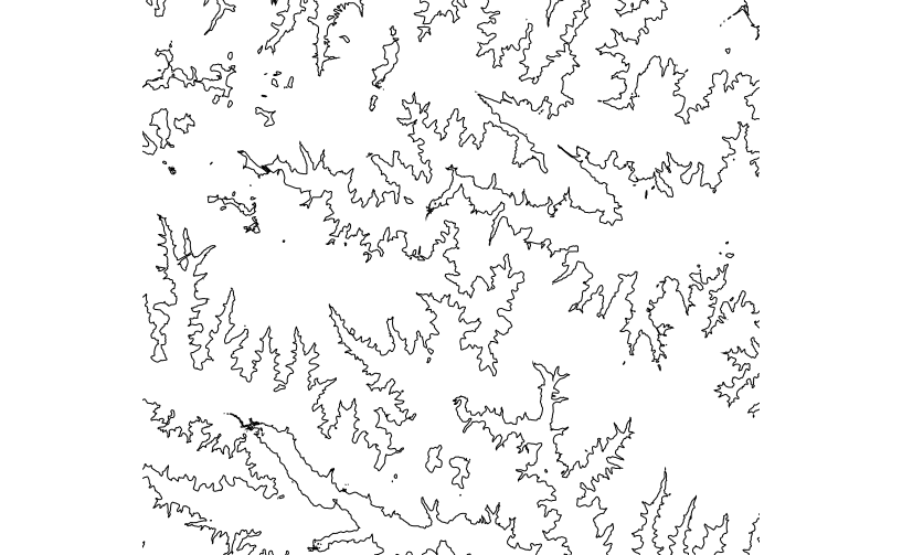

   Using the small NC data set's PERMANENT mapset I ran
r.contour in=elevation out=contours levels=60,90,120,150
and produced the attached map.
   Is this what you asked?
Regards,
Rich

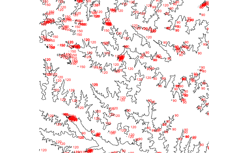

On Thu, 6 Oct 2016, Stuart Edwards wrote:
nice to label them too - see label tab in d.vect
Stu,
   OK. See attached.
Rich
(attachments)

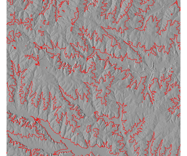

   For an example of using levels with r.contour this example uses the
elevation map from the North Carolina database:
   g.region raster=elevation
   r.contour in=elevation out=contours levels=60,90,120,150 --o
   d.mon wx0
   d.rast elevation_shade
   d.vect contours color=red
To make the screenshot more attractive (about screenshot size and
quality, see https://trac.osgeo.org/grass/wiki/Submitting/Docs#Images),
we could include the shaded terrain as background:
   I don't have pngng installed here; the attached image is scaled to 600 dpi
horizontal and propotional vertical density.
Rich
(attachments)

Thanks & sorry for the delay. I have added your example to the manual
page (both trunk and 7.2.svn).
Best
Markus
