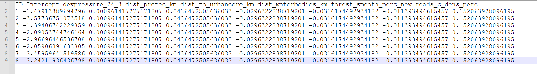

Any idea what the problem might be? The potential input table seems fine to me (see picture below). I do not know what it could mean that the number of columns is wrong, as I am not aware of any specifications or given requirements in the potential file for r.futures.calib.

I suspect the problem is in the delimiter, try to replace all the spaces in the potential CSV file with commas. The default delimiter was changed between FUTURES versions, so perhaps that might be the problem.
