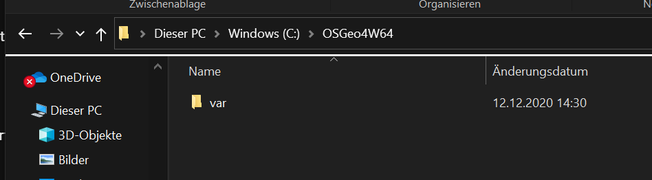

I have downloaded, installed and deleted the program now for so many times, that there might be some residual data from before somewhere on my computer. Could this be the problem?
Is there a way to properly uninstall all the programme data? I haven’t been able to find such a way as OSGeo4W or Grass won’t show up in my programme list.

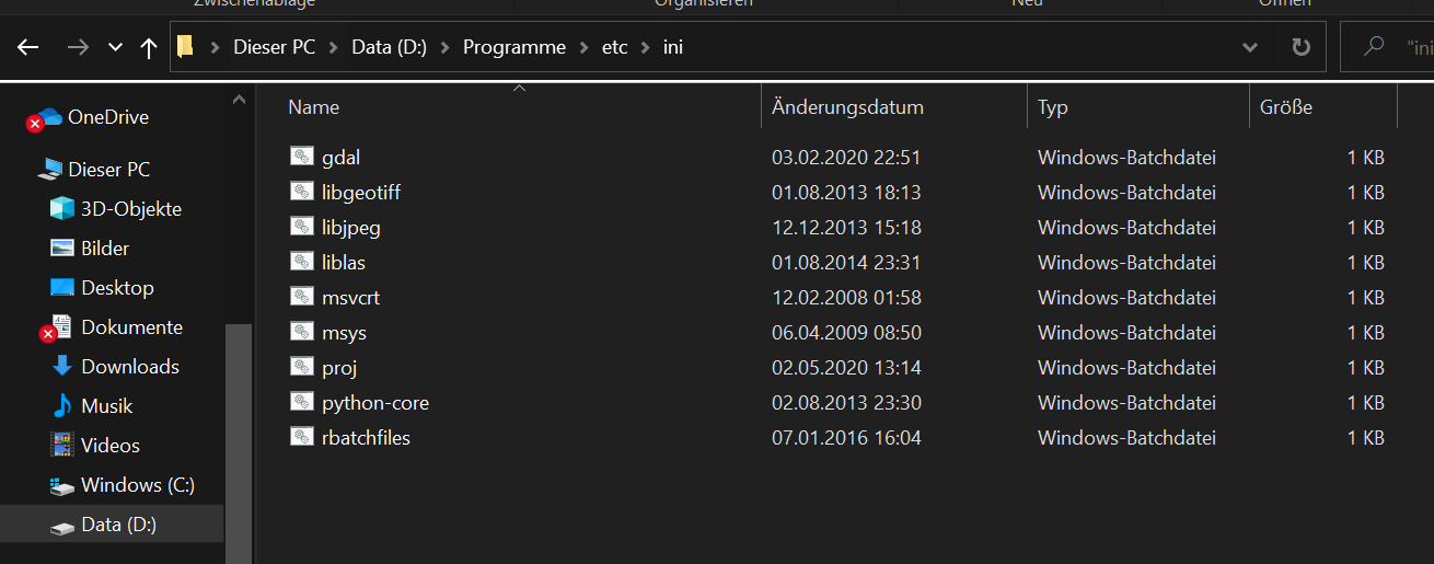

no, the GRASS-R-bridge isn't installed.
be aware that if you install the previous rbatch version and then in a next
run of OSGeo4W install of e.g. winGRASS 7.9.daily., then the not working
rbatch version is installed again. it's a drawback of the minimalistic
OSGeo4W package system.
install the previous working rbatch version, then check:
in
- C:\OSGeo4W64\etc\ini\rbatchfiles.bat
and
- C:\OSGeo4W64\apps\rbatchfiles with 18 files inside are there.
the important file is rbatchfiles.bat in the ini-subfolder.
if it's there, then it should work like here within and outside a winGRASS
session in the OSGeo4W shell.

There is one more OSGeo folder on my Disc (I do not know why) which is similarly empty:
Am Sa., 12. Dez. 2020 um 14:35 Uhr schrieb Tom Hackbarth <txhackbarth@gmail.com>:
Hi Helmut,
I have found the folder with the 18 files, but not the first one. The etc folder is almost empty in my case (see picture below).
Am Sa., 12. Dez. 2020 um 13:48 Uhr schrieb Helmut Kudrnovsky <hellik@web.de>:

Okay I have found it now, strangely just in my programme files folder:
Does it make sense to transfer this data into the OSGeo64W Folder?
Am Sa., 12. Dez. 2020 um 14:40 Uhr schrieb Tom Hackbarth <txhackbarth@gmail.com>:
Hi Helmut,
for a workaround:
we’re working to bring the R-winGRASS-bridge back to OSGeo4W
best regards
Helmut
Sent from: http://osgeo-org.1560.x6.nabble.com/Grass-Users-f3884509.html
grass-user mailing list
grass-user@lists.osgeo.org
https://lists.osgeo.org/mailman/listinfo/grass-user

ok, at your computer, there seems to be some incomplete OSGeo4W installation
leftovers here and there. not sure why.
it's recommended to install OSGeo4W 64 bit into C:\OSGeo4W64, not into
c:\Programme
as we don't know, how (in)complete the OSGeo4W installation(s) are, I
suggest to delete both of them and try to re-install a new attempt in
C:\OSGeo4W64.
then try my procedures mentioned before in previous mails.
the content of C:\OSGeo4W64\etc\ini should be something like:
gdal.bat
libgeotiff.bat
libjpeg.bat
liblas.bat
msvcrt.bat
msys.bat
proj.bat
python-core.bat
qt4.bat
rbatchfiles.bat <=
especially rbatchfiles.bat
best regards
Helmut
