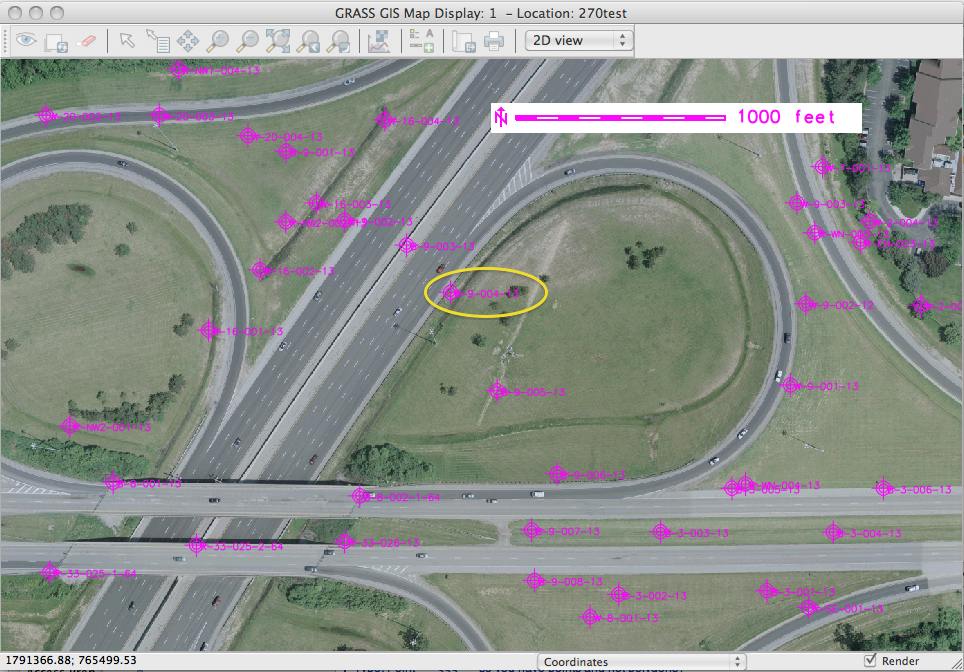

Hi –
This simple project involves digitizing and displaying the location of about 200 borings. There is a pair of state plane co-ordinates and an alpha-numeric boring designator - and of course a cat - for each of them. The borings were duly digitized using v.digit in GRASS 7 (OS X) and after a number of edits (relocations, modification of some attributes, and some deletions) the file displays correctly using d.vect. It has also been satisfactorily exported as a shapefile as part of an effort to create a labeled dxf CAD layer.
However, v.report creates a table that appears to randomly (unlikely, I know, but that’s how it appears) redistribute the pairs of co-ordinates among the points.
For example, at one boring location v.what generates:
v.what -a map=Borings@PERMANENT layer=-1 coordinates=1791366.79821,765499.232745 distance=2
East: 1791366.79821
North: 765499.232745
Map: Borings
Mapset: PERMANENT
Type: Point
Layer: 1
Category: 142
Driver: sqlite
Database: /Users/stu/grassdata/270test/PERMANENT/sqlite/sqlite.db
Table: Borings
Key column: cat
cat : 142
boringnumber : B-9-004-13
However, v.report gives:
142|B-9-004-13|1793470.46145773|765224.666245354|0
for cat 142 which is the location of one of the other borings. Almost all of the borings are incorrectly identified in the v.report table. I tried v.build before running v.report but the results were the same.
Any assistance would be much appreciated as I would like to have an accurate table of these locations.
thx
Stu
On Fri, Jun 14, 2013 at 2:23 AM, Stuart Edwards <sedwards2@cinci.rr.com> wrote:
Hi --
So, just to be sure to understand: you have digitized circular polygons?
know, but that's how it appears) redistribute the pairs of co-ordinates
among the points.
The coordinate pair specified here, where does it fall into the polygon?
Onto the boundary or onto the centroid or "anywhere" within the
polygon?
East: 1791366.79821
Map: Borings
Mapset: PERMANENT
Type: Point <<<---- so you have points and not polygons?
Layer: 1
Category: 142
Driver: sqlite
Table: Borings
Key column: cat
cat : 142
What does this print:
v.info -t Borings
Perhaps you could post a small map screenshot of the area of interest
along with the map scalebar put on.
Markus
Markus
Thanks for your response.
Hi --
No, this becomes a vector points map that is then displayed over a raster photo base using the available symbols. The attributes provide the boring numbers that are also displayed.
among the points.
polygon?
This one is roughly in the middle of the 'cloud'
East: 1791366.79821
Map: Borings
Mapset: PERMANENT
yes -
Layer: 1
Category: 142
Driver: sqlite
Table: Borings
Key column: cat
cat : 142
v.info -t Borings?
v.info -t Borings
nodes=0
points=212
lines=0
boundaries=0
centroids=0
areas=0
islands=0
primitives=212
map3d=0
Note - the total boring count is only 186 and there are no other features on this map.
Please see attached. The screen shot was taken with the cursor on the boring location (circled) and you can see that the co-ordinates correspond reasonably well with the result of v.what mentioned above.
Is it possible that the db is not keeping up with the edits that are made subsequent to digitization and that when a boring is moved, points are not properly deleted, although a new point is created, and all the following cats are thrown off by a corresponding amount? All of the co-ordinate pairs are perfectly represented - just with the wrong attribute.
Thanks again for your assistance ......
Stu
