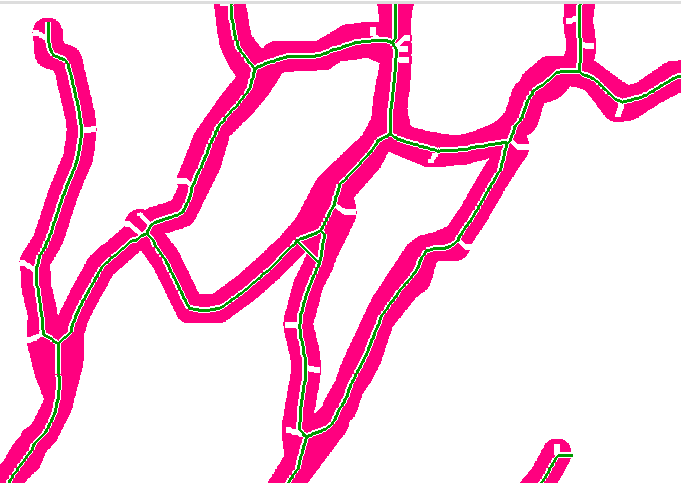

Hi all. I have run into a quirk using r.thin, but I am not sure whether or not it is a bug. I have a raster that was generated from multiple GPS tracks using v.rast followed by r.buffer. Using r.thin followed by r.to.vect creates a vector that must then be cleaned using v.clean to remove dangles (so far, so good).
The quirk is that r.thin occasionally creates a triangle at the intersection of two lines instead of two intersecting lines. All of the examples I have seen involve relatively acute angles (less than 25 degrees??). I have attached a screenshot that shows the raster in magenta, the vector with dangles in white, and the cleaned vector as (a thinner) green. There are numerous acute angles that generate the vectors I would expect, with one exception in the center.
Is this expected behavior? If so, is there an easy way to search for all such resulting triangles in a vector or to remove all such extra lines in a vector? If not, is there a way to fix it?

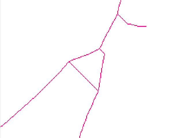

Although I figured out how to file a bug report on this, http://trac.osgeo.org/grass/ticket/636, I am not sure how to respond directly to comments on the ticket.
Hamish, I used the screenshot showing the vectors because I had already created it to look for artifacts. The extra line that makes the triangle is also present in the thinned raster (screenshot attached).
Thanks, -Dwight
Thanks, -Dwight
<r.thin_raster.png>

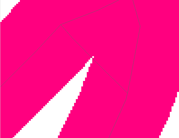

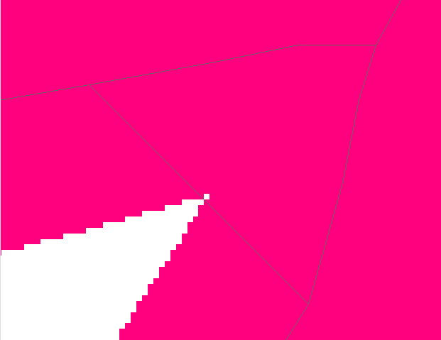

Follow-up... the two examples of this happening in this particular file each have a single white pixel surrounded on 7 out of 8 directions by red pixels, but still touching a white pixel on a corner in the 8th direction (see two screenshots). I suspect that r.thin is treating this as a hole even though it is touching an edge. Another way of saying this is that the two red pixels touching in 1 out of the 8 directions are treated as a line.
Perhaps there could be a flag to control this behavior.
Thanks, -Dwight
Thanks, -Dwight
<r.thinpinched_1.png><r.thinpinched_2.png>
It does appear that the observed quirk is caused by the way r.thin treats pixels that touch only at their corners. I thought I could work around this my using r.neighbors method=mode. Although this does eliminate single empty pixels, it sometimes generates new ones elsewhere. Although I am sure there is a clever way to use r.mapcal, I ended up inverting the map, running r.grow, and inverting again (the equivalent of what could be called r.shrink). As far as I can tell, this eliminates single pixel holes without generating new ones.
