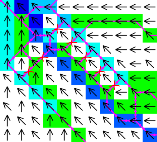

following the wiki doc about stream extraction [1], once the stream layer thinned and vectorized,
there are many small arcs i would like to remove (see attached capture [2]).
So, with the underlying drainage direction map [3], and the resolution r, i would like to delete segments
- about r*sqrt(2) long
- whose azimuth is more than 45° different from the pixel value under its starting point.
But i still haven't figured a way to achieve this.
Do you have any advice ?

This might be possible, but I think the best approach would be to choose the correct threshold value for r.watershed from the start.
Trying to manually “fiddle” with the stream network will most likely leave you with disconnected segments, or other inconsistencies.

+1
Please try r.stream.extract in order to get a clean vector stream network. The approach r.thin + r.to.vect creates noise and does not always follow flow directions.

Thank you for your help,
i’ll try r.stream.extract
I do have set a small threshold value but it is on purpose.
The streams i am trying to model are not hydrological.
