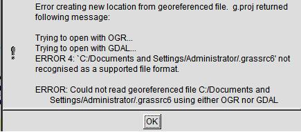

In fact I have create two folder nlocation and nmapset in the hiberarchy of (nlocation/nmapset),then I start the grass with the gui ,I got the error messgae that I am mot clear?..

Please (re)post the error.

Hi:Markus Neteler
Thanks for your reply.
I have upload the error information as a annex.
The following is my working,I wonder if you can give me some advises:
We provide a web server for other clients to do some geoprocessing.Here suppose I have two process A and B. Both of them are designed to handle raster data(tiff). So in each of them I have to do the following steps:
  1. import tiff to grass format
  2. handle the tiff and get the grass result
  3. export the grass result to tiff
    I am now confusing with the data import and export.
    As what you have side,I should do the same work in each process (A and B) – g.region… r.buffer…export.
    So the problem occurs,the default location and mapset,should I define the respective location and mapset in different process(A and B)? If so I should write a grassrc file for each process?
