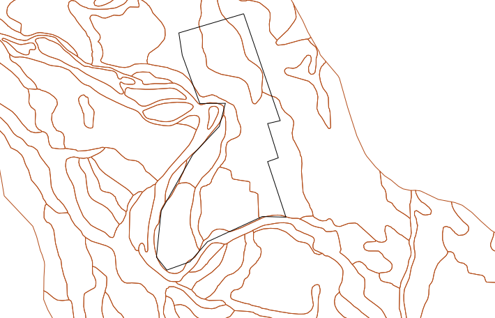

Micha, et al.:
   I also added a centroid and reprojected from WGS84 (lon-lat) to the
project's location. Now I would appreciate advice on adjusting the boundary
of the black area on the attached screenshot -- along the left and bottom
sides -- to the adjacent orange lines.
   For some reason I've yet to learn interactive vector editing in 7.5.svn is
not working for me. I would like to understand why not, but there may be
alternatives of which I'm unaware and learning these would be valuable. All
suggestions and advice welcome.
