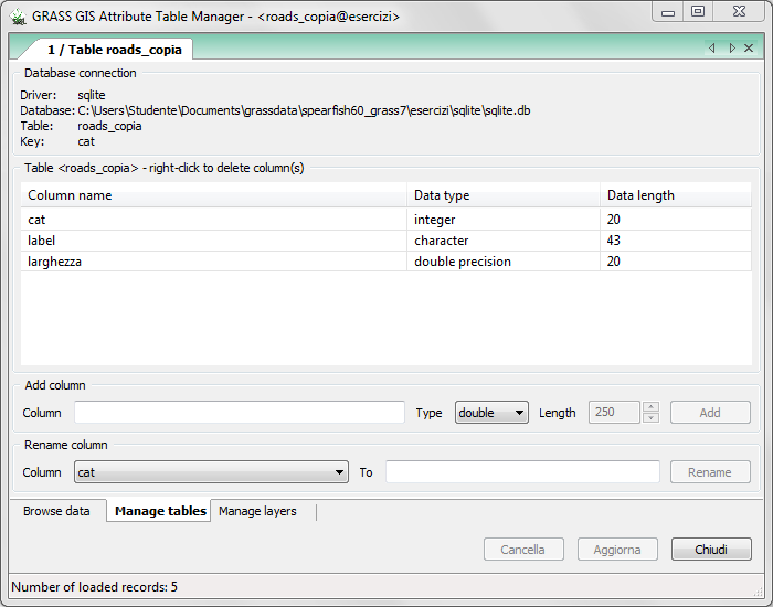

a) Made a copy of roads (in Spearfish) named roads_copia
b) With Show attribute data Fig.1 the columns are correctly displayed.

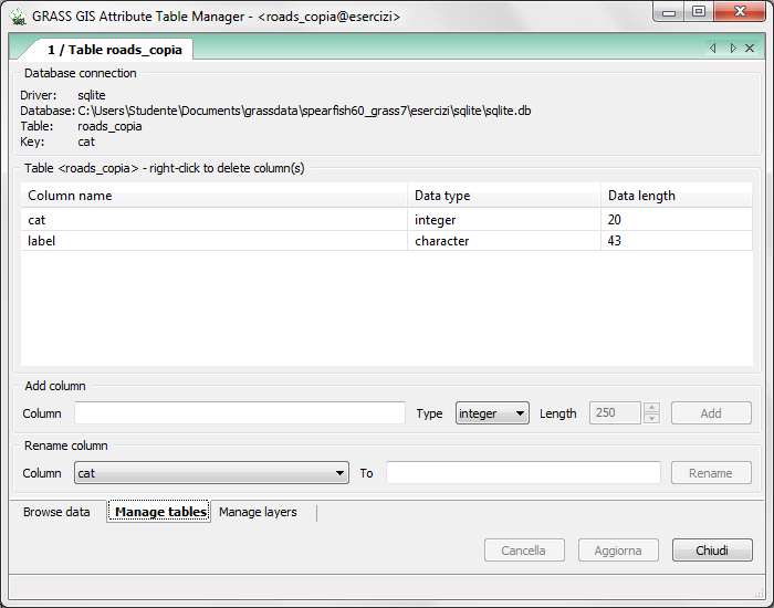

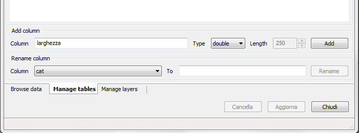

c) With Manage tables > Add column a column named larghezza has been added Fig.2

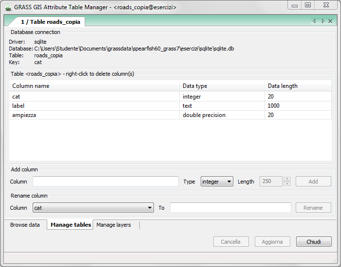

d) The column is correctly inserted Fig.3

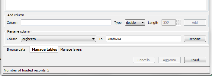

e) With Rename column the column name has been changed in ampiezza (fig.4)

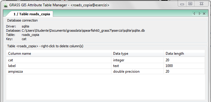

f) The Data lengths are changed as follows Fig.5.

Hi,
2018-03-02 12:51 GMT+01:00 Aldo CLERICI <aldo.clerici@unipr.it>:
Something wrong?
seems to be a bug. If you open Attribute Table Manager again, it's OK, right?
Ma
Martin Landa
http://geo.fsv.cvut.cz/gwiki/Landa
http://gismentors.cz/mentors/landa
No, it's not (Fig.6)
A. Clerici
