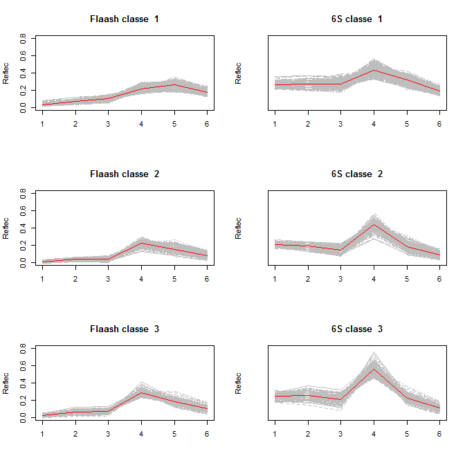

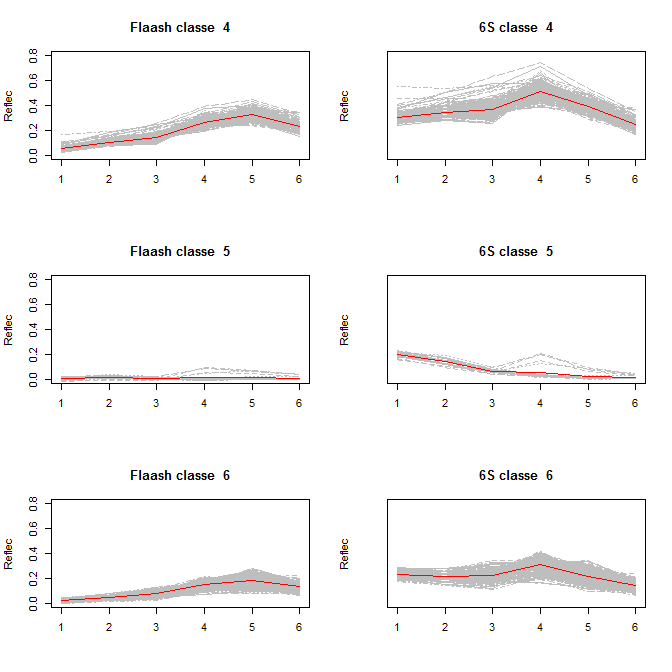

Hi Markus M et al.,
Thanks!! You answer has removed a long standing doubt of mine. So the
255 output from i.atcoor is 100% reflectance. Great.
Now here is another analysis (hope this time correct). I've taken the
same random points from before and did a k-means clustering based on
the i.atcoor results. I've then compared the average spectral profile
for each class (atcoor vs. flaash). Flaash output has been divided by
10000 and i.atcoor, by 255 to scale reflectance from 0 to 1.
From the graphs we see that the spectral profile for each class is a
bit different. Red line is the mean and the gray lines are the
spectral profile for all points in that class. For instance, in class
5 (water), flaash has lowered reflectance values on bands 1 and 2 much
more then i.atcoor. It appears as thoug Flaash will apply a stronger
correction then atcoor, even using high visibility values.
Could the different aerosol model used have caused this difference?
Flaash used rural aerosol model and i.atcoor used continental...
Cheers
Daniel

On the i.atcoor issue, I did a quick comparison of a TM image
corrected using i.atcoor (Grass 6.4) and Envi FLAASH, which is based
on MODTRAN and should be similar to 6S.
A detailed explanation is attached on the PDF file but basically this
is what I did:
1) Correct a TM image using the same atmospheric parameters in atcoor and flaash
2) Generate a bunch of random points
3) Results from atcoor and flaash are linearly correlated but
regression coefficients are not the same for the different bands.
This makes it difficult for comparing the reflectance from i.atcoor
with measured reflectance spectra since we are not sure what the max
value of from i.atcoor output (255) means. Is it the maximum
reflectance (100%)? Or is it the max reflectance in the evaluated
image? That is, if the image has a max reflectance of 40%, then the
output reflectance image from i.atcoor will put a value of 255 for 40%
reflectance.
Sorry for the long and confusing email. The good news is that i.atcoor
is giving results very well correlated with the ones obtained by a
respected atm correction scheme from a comercial package - hurray! We
only need to figure out the scale of the output :slight_smile:
Thanks
Daniel
PS - I changed the subject line so it wouldn't mix with the sextante discussion
