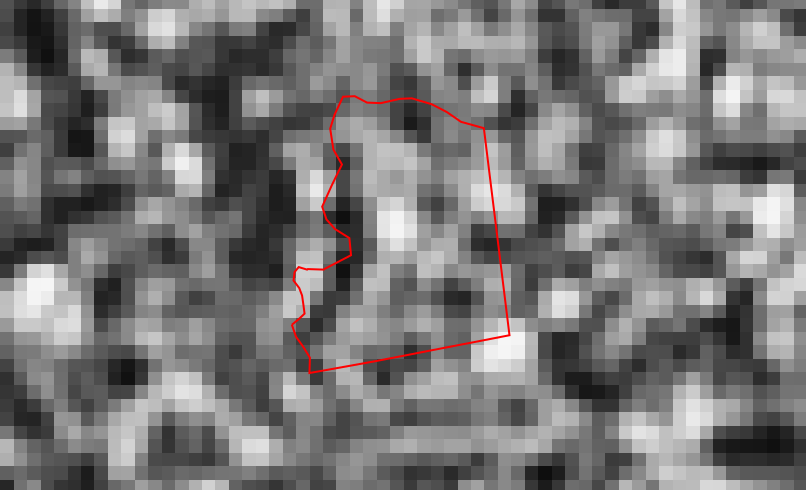

Hi,
thank you for your replies. To give a little more context: I selected my polygon areas to be > 0.5 ha each (this would be 50000 mq if I’m not mistaken) and I’m sampling NDVI maps at 10m resolution (the region being the same as NDVI maps). So I think I need an idea on how to debug the areas that were excluded to check them individually to see what could be the problem…
Regarding the alignment problem, if I understand it correctly: if the polygon doesn’t include the center of the raster beneath it, can’t retrieve the value and the polygon is discarded? But a value exists, so it would be correct that it returned a value in any case. But I admit I don’t have a full grasp of the problem.
Margherita Di Leo
Hi Madi,
With this combination (polygon size vs. raster resolution), the shape of the polygons can be an issue (narrow areas that do not cover the center of any pixel).
Debugging should be simple with v.db.select or v.extract.
Areas that did not get rasterized should be NULL in the column with statistics computed with v.rast.stats.
In verbose mode v.rast.stats (or probably even v.to.rast) should probably give a more informative Warning message (e.g. listing categories not rasterized). It also would help if you can rasterize the areas yourself and provide a raster with categories as (optional) input to v.rast.stats…
For high resolution data like yours, the speed improvement of multiple raster input might help quite a bit esp. with many maps in the time series. Will see if I can come up with a patch rather soon…
Cheers
Stefan

Margherita Di Leo
Thank you Stefan for your help! I figured what happens. v.strds.stats with default method produces in my case a corrupted output, topology is there but there’s no table associated to it. If I specify method=average, I do obtain the table, and the mystery is solved: some of the polygons fall into a nodata (due to cloud mask). If anyone else can reproduce the corrupted table issue, I can file a ticket for that.
Thanks for help!

Hi,
excuse me if I return on this. I have again the same problem, of v.strds.stats skipping lots of polygons. Now I’m using a brand new dataset - strds of Sentinel 1 and a brand now vector of polygons - and the skipped polygons are not narrow, I’m sure that there are cells centroids in it. See for example screenshot attached, depicting a polygon that was skipped. I also tried to run v.strds.stats on that polygon alone, like:
v.strds.stats in=big_areas2@PERMANENT where=“cat == ‘1’” strds=db_cross_pol@scaled out=test method=average
v.info test
(attachments)
Margherita Di Leo
Ciao Margherita,
This is strange. The area (I assume it is an area though your image just shows the boundary) should definitely get rasterized and thus analysed in v.strds.stats.
Can you post the output of:
v.category input=big_areas2@PERMANENT option=report
and
v.info test -t ?
I double-checked, and the possibility to rasterize also centroids is unfortunately not handed down to v.rast.stats (and moduls build ontop of that, like v.strds.stats). This should be done for GRASS version >= 7.6 (e.g. by adding centroids to the default selection of types to rasterize in v.to.rast) and is probably worth a ticket.
Cheers
Stefan
Hi,
Thanks for help!

Ciao Madi,
is the region properly set?
@Stefan in this case, if the centroid only is rasterized, then stats will also belong to that pixel only? AFAIU, we don’t want that, but stats for the area. Or rasterization of centroid would have a different effect?

El vie., 9 ago. 2019 a las 21:29, Stefan Blumentrath (<Stefan.Blumentrath@nina.no>) escribió:
Ciao Margherita,
and
v.info test -t ?

Ciao Margherita,
and
v.info test -t ?
Cheers
Stefan
v.info test

I confess I hadn’t look much further into it because I thought it was a problem with nodata, but this is not the case and I think it’s worth of further investigation. Thanks for any pointers.
