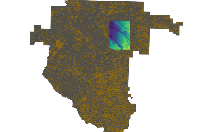

   I am trying to add additional DEM maps to the project location. There is
one DEM overlaid on a soil mapping unit map for the county in the attached
screenshot. My reading of the g.region manual page did not let me find the
answers I need.
   The computational region is set to the soil map. Attempting to re-project
the DEM to the immediate west of the existing one fails; grass7.5svn tells
me, "ERROR: Input raster map is outside current region." I don't understand
why this is since the soil map is much larger than the DEMs and I used
'g.region vect=soils' to set the size.
   Another question is how I can expand the region to add a DEM immediately
below the one on the attached map. The eastern edge of the DEM is beyond the
limit of the soil map.
   Learning more about manipulating regions while assembling project maps
will help me now and in the future. Pointers to more resources for me to
read will be very helpful.
Rich
(attachments)
If I understand, you have DEM tiles in one projection (location) and you’re trying to use r.proj to transform the tiles into a different location.
If that’s the case, typically you would use the r.proj flag ‘-g’ to get the region settings in the target location from the raster extent in it’s source location. So you might do something like:
g.region -p r.proj -g loc= map= input=``
then run r.proj without the -g flag and you should get the reprojected raster.
Finally, once you have all the tiles reprojected, use
g.list raster pattern=<....> sep=comma
to get a list of all the tiles, then g.region -p rast=<list of tiles>
to set the computational region to cover all tiles.

On Mon, 9 Jul 2018, Markus Metz wrote:
The source's region does not matter, what matters are the extents of the
source raster map.
Markus,
   I should have remembered that they're different.
Apparently the input raster, when reprojected to the current region in the
location/mapset, does not overlap with the current region.
You can check the reprojected extents of the input raster with r.proj -g.
   This I did:
r.proj loc=elwood map=PERMANENT in=elwood_dem2013 -g
WARNING: Input and output locations are the same
Input map <elwood_dem2013@PERMANENT> in location <elwood>:
n=1281118.49999997 s=1235035.49999995 w=828457.49999998 e=861685.49999999 rows=15361 cols=11076
   Then I followed the 'box' map method of setting the target region as shown
in the manual page's Notes, paragraph 4:
# In source location:
v.in.region -d out=elwood_region
# In target location:
v.proj in=elwood_region loc=elwood map=PERMANENT out=elwood_reproj
g.region -g
projection=99
zone=0
n=201663.78224162
s=137006.09426117
w=2314182.92402788
e=2388673.19838691
nsres=0.99999517
ewres=1.00000368
rows=64658
cols=74490
cells=4816374420
g.region vect=elwood_reproj res=1 -a
r.proj loc=elwood map=PERMANENT in=elwood_dem2013 res=1 method=lanczos
   Please point out what I missed or did incorrectly.
Best regards,
Rich
On Mon, Jul 9, 2018 at 6:11 PM, Rich Shepard <rshepard@appl-ecosys.com> wrote:
The source’s region does not matter, what matters are the extents of the
source raster map.
Markus,
I should have remembered that they’re different.
This I did:
Input map elwood_dem2013@PERMANENT in location :
Then I followed the ‘box’ map method of setting the target region as shown
in the manual page’s Notes, paragraph 4:
In source location:
first set the region to match the raster:
g.region raster=elwood_dem2013
now proceed as before:
In target location:
g.region -g
projection=99
zone=0
n=201663.78224162
s=137006.09426117
w=2314182.92402788
e=2388673.19838691
this:
nsres=0.99999517
ewres=1.00000368
is probably not what you want, it is recommended to align the region to exactly 1 map unit:
g.region -p -a res=1
before reprojection
rows=64658
cols=74490
cells=4816374420
You should notice a difference when using the suggested g.region calls.
Markus M
Best regards,
Rich
grass-user mailing list
grass-user@lists.osgeo.org
https://lists.osgeo.org/mailman/listinfo/grass-user
Markus,
   Okay. I thought the vector box matched that of the raster. I'll make that
change.
this:
nsres=0.99999517
ewres=1.00000368
exactly 1 map unit:
before reprojection
   I think this is what I did:
   I'll set the source region to the raster map prior to creating the vector
box. Will post results.
Thanks,
Rich
   That made all the difference. Perhaps the example ("v.in.region method")
can have this added at the top so it reads,
# In the source location, use v.in.region to generate a bounding box around the
# region of interest:
g.region rast=<user1>
v.in.region -d output=bounds type=area
Thanks for pointing this out to me,
Rich
