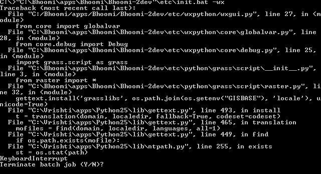

Please see the error when start bhoomi(Grass).
Inline image 1
Thanks & Regards,
Swapan

Hi, I don’t understand in which circumstances are you running grass. However, (Python exception) KeyboardInterrupt would mean, in Unix command line, that you pressed Ctrl+C in order to interrupt the program.
BTW, for the development of any grass GUI I would suggest you to develop keep it separate from g.gui (wxgui.py) command (which is called by init.bat) and start your new application separately from command line (as a python script, i.e. “python path/to/my/app.py” or as a grass module as g.gui.* modules do).

I am trying to change the grass wxgui. I got this error by interupting the grass run as when I press the start grass button it automatically quit.
I would not like to create new extend gui as this is time consuming.
Alternatively I have to do that as you told by swithing from init.bat to my new gui.
Thnks & Rgd
Swapan
