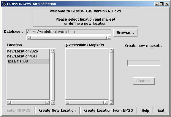

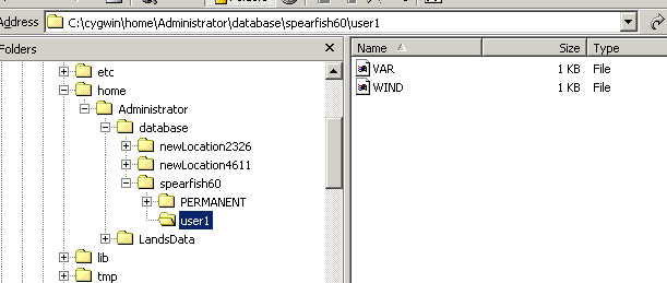

I have installed GRASS 6.1 CVS from the procedure “Cygwin Setup package 1” in http://geni.ath.cx/grass.html. Then spearfish60 sample data are installed
into a home/[user]/database directory. However, after entering GRASS, and
clicking spearfish60 Location, I can’t find the PERMANENT and user1 Mapsets. Please find the screen dump.
Do I need to set something so that I can access the data? If not, what are the possible problems?

Maybe, is only a permissions problem. Are the mapsets own by the grass user? Can you create a new mapset? Change permissions for spearfish60 and try again.
