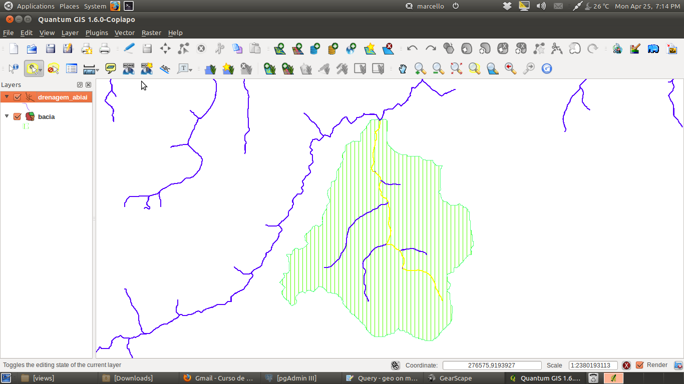

I need a query that returns the greater length of river within a basin. Does anyone have any suggestions on how I can solve this problem?
The rivers are formed by segments. if each were a continuous line would be easy (but is not, lol).
Here is a print-screen of the problem, in yellow is what would be the result of the query.
Thanks in advance,
Marcello,
   I did this a while ago by using mapcalc() to add the lengths of river
segments and show the total. Don't recall the algorithm off hand but I'm
sure you can quickly work it out.
Rich
