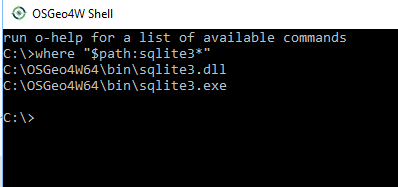

When I run the where from the windows console I get this:
When I do it from the OSGGeo4W Shell. I get this:
there is a sqlite dll hell caused by ArcGIS and anaconda.
kind regards
Helmut
