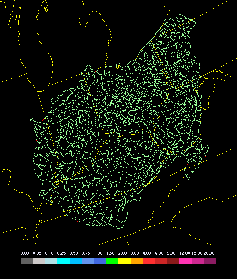

Jonathan,
I think you have the problem correct. Attached is a gif image that shows my 686 subbasins (polygons) in green. I need to get average values of temperature & precipitation for each of the polygon areas for numerous rasters. From the values, I then generate the time series files for each subbasin area (i.e., each polygon).
Thanks very much for your reply!
