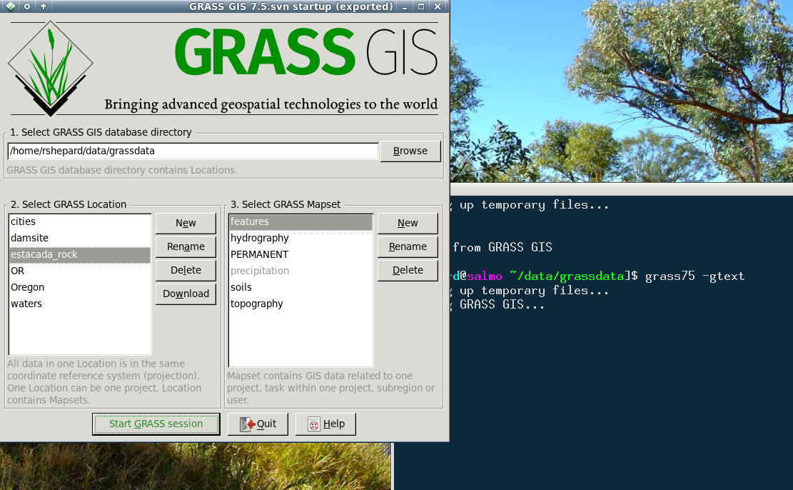

   Not with 7.5svn. When I use '-gtext' I get the location wizard. After I
run through the process it goes away and I am left at the command line.
Regards,
Rich
* Rich Shepard <rshepard@appl-ecosys.com> [2018-07-11 09:24:01 -0700]:
On Wed, 11 Jul 2018, Nikos Alexandris wrote:
By the way, the -gtext option is not relevant. It merely shows the
welcome/logo screen when launching a GRASS GIS session, then jumps back
to the command line.
Nikos,
Thanks. Then, the help's description deserves an update. Currently:
-gtext use text based interface (show welcome screen) and set as default
Nikos
Nikos,
   Then I guess an update is due. See attached screenshot. It has part of the
virtual console with the entered command and the resulting location wizard.
Best regards,
Rich
Best regards,
Rich
Sure, I tried it before suggesting to update the help's description.
I think it was not like that. Since I don't use frequently this option,
I didn't notice.
Thanks, Nikos
