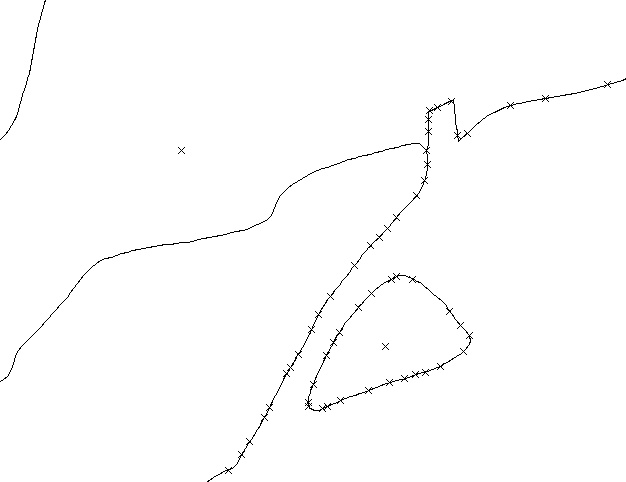

Hello:
I imported a shape file. Some, but not all, of the features show each point on the boundary as a centroid. See attached image which was plotted showing the centroid as an 'x'.
I would like to remove the incorrect centroids.
I tried using v.clean tool=rmdac but this did not work.
Does anyone have any ideas how I could do this.

On 15/12/06 04:55, Dave Kent wrote:
Hello:
This actually looks like you have a lot of overlaps in the boundaries which then create areas. If you zoom in you will see an area for each centroid.
You might be able to solve this by setting the 'snap' parameter of v.in.ogr.
