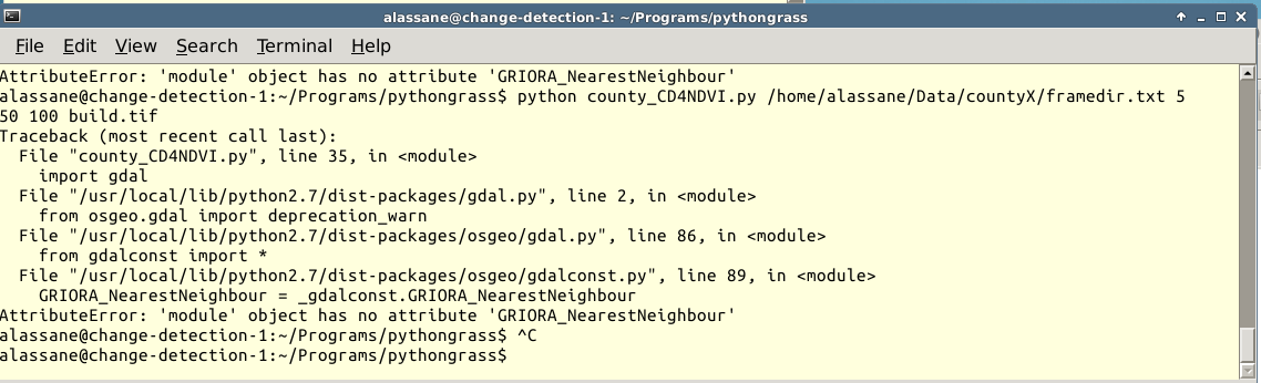

Group,
I am running a python code (worked well on earlier gdal version but not on 2.1) calling gdal with the following errors.
Inline image 1
The code start as follows…
#!/usr/bin/env python
import os
import sys
import subprocess
import shutil
import binascii
import tempfile
import gdal
from gdalconst import *
from datetime import datetime
Your comments/suggestions are appreciated.
Alassane
