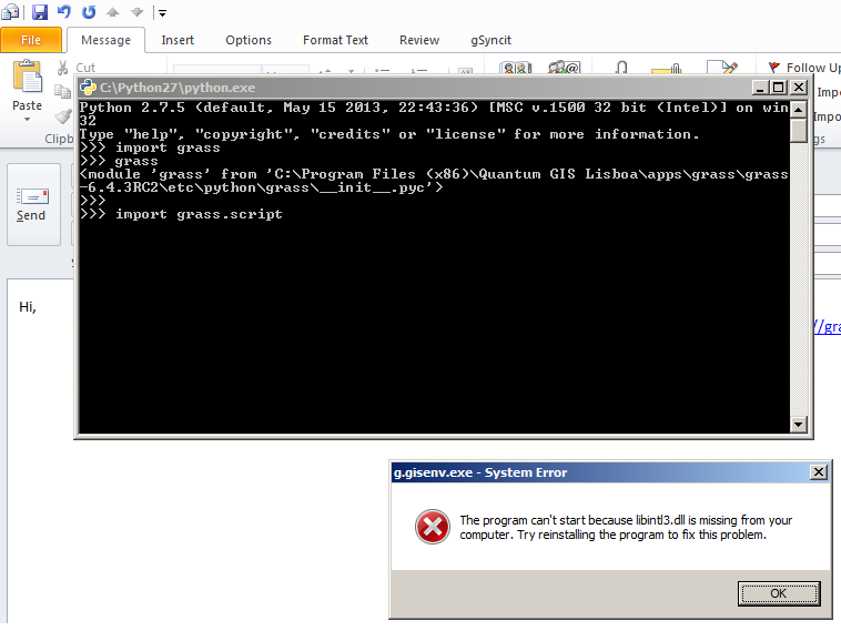

  I am able to import grass in python, but when I try to import
grass.script, I get an error like the one in the picture. I checked an d I
DO have the missing file in the folder C:\Program Files (x86)\Quantum GIS
Lisboa\apps\msys\bin , so I don't really know what the problem is
  A Google search also did not help. Suggestions?
It searches for "libintl3.dll" according to your screenshot.
See
http://grasswiki.osgeo.org/wiki/WinGRASS_errors#Error_message_.22This_application_has_failed_to_start_because_libintl3.dll_was_not_found.22._.28or_libiconv2.dll_and.2For_regex2.dll.29
"Reinstalling of the "msys" package in the OSGeo4W installer will
bring it back. "
Hope this helps,
Markus
