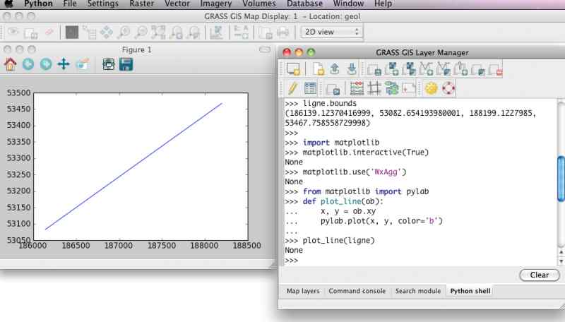

If you know Python, you can combine grass.script with all the others geospatial or scientific modules (and matplotlib, for example, even in the GRASS Python shell).
Images intégrées 1
You can also combine grass.script with qgis.core or r2py (R) or serve locally the GRASS layers with Django/GeoDjango.
