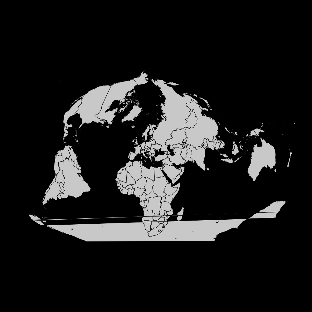

Reprojecting this map in "Bertin", as a Geopackage:
ogr2ogr -t_srs "+proj=bertin1953 +wktext" -f GPKG TM_WORLD_BORDERS_SIMPL-0.3_Bertin1953.gpkg TM_WORLD_BORDERS_SIMPL-0.3.shp
and importing and cleaning it in GRASS GIS:
grass -c TM_WORLD_BORDERS_SIMPL-0.3_Bertin1953.gpkg /geo/grassdb/global/bertin_1953 -e

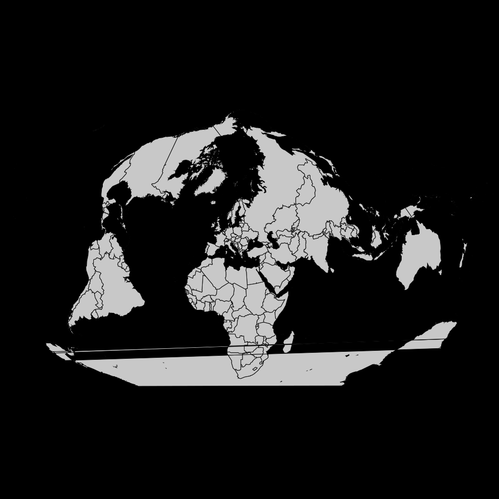

v.clean -c input=tm_world_borders_bertin output=tm_world_borders_bertin_clean error=cleaning_errors tool=snap,rmdangle,rmbridge,chbridge,bpol,prune threshold=10 --o
works, with an undesired effect of a huge self-overlapping Antarctica,
before and after cleaning too (see attached images:
tm_world_borders_bertin.png and tm_world_borders_bertin_clean.png).
I guess this is another case of a global borders map problem to
understand.

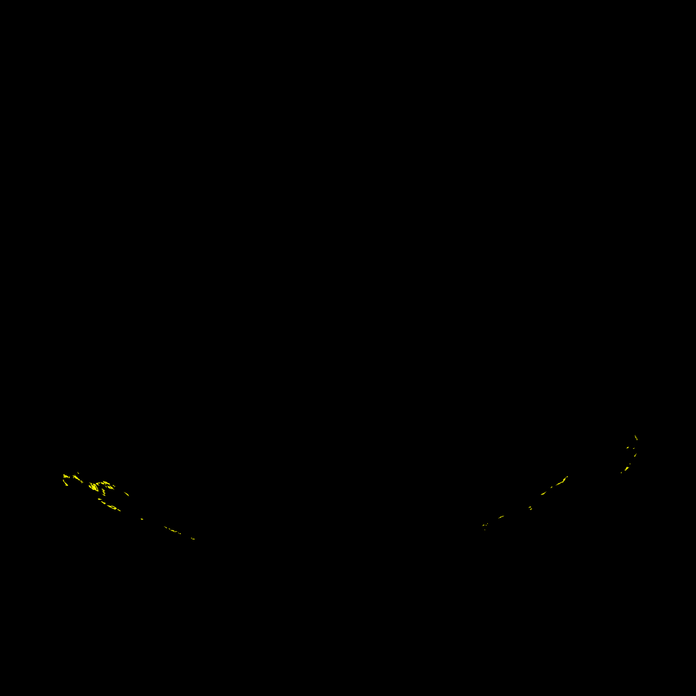

Although the resulting `build_errors` map is not empty, i.e.:
v.info -t build_errors@tm_world_borders
90 degree south is exceeded by 0.032928 cells
360 degree EW extent is exceeded by 1 cells
nodes=69
points=0
lines=0
boundaries=69
centroids=0
areas=69
islands=69
primitives=69
map3d=0
nothing appears on-screen when trying to draw these boundaries.

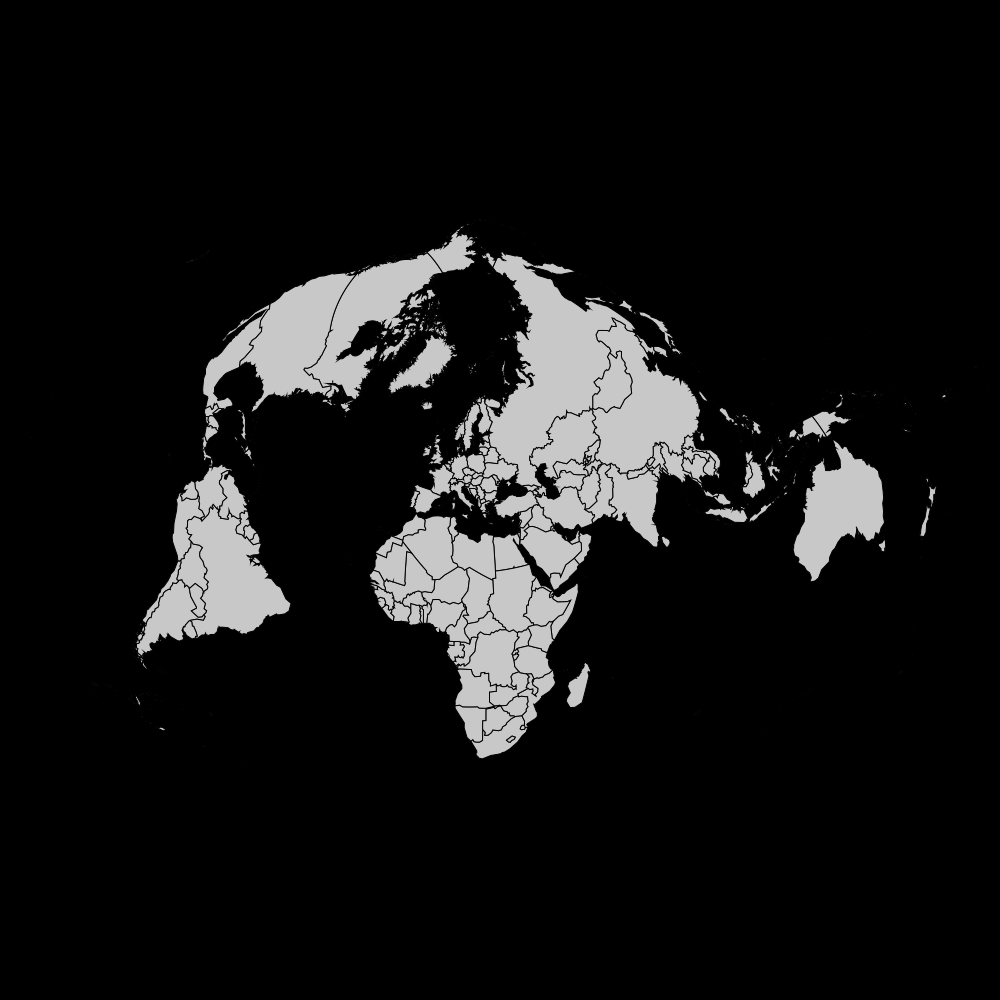

both of which show something, I guess, meaningful. Pulling these over in
the "Bertin" Location:
v.proj location=wgs84 mapset=tm_world_borders dbase=/geo/grassdb/global input=tm_world_borders
v.proj location=wgs84 mapset=tm_world_borders dbase=/geo/grassdb/global input=tm_world_borders_clean
make Antarctica too small (see also attached images: Antarctica.png and
tm_world_borders.png and tm_world_borders_clean.png) which might be ok.
