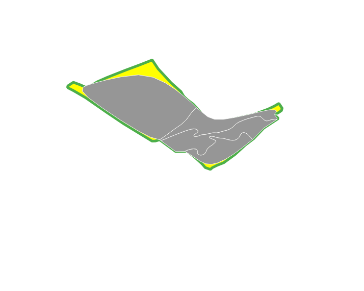

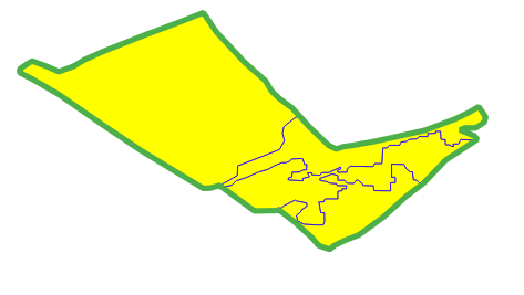

I'm using v.generalize in a script (excerpt included below) to smooth
the boundaries of a polygon vector dataset. In the attached example
(input_vector.png), I would like to *only* generalize the internal lines
(blue), and leave the external boundary (green line) unchanged. I
thought that the flag, '-l' might provide this functionality, but
unfortunately the resulting external boundary is changed significantly
(attached vgeneralize_output.png).
Is this functionality available in v.generalize or is there another way
that this could be achieved in GRASS?
Thanks in advance.
Best regards,
Daniel.

I think I have a series of steps that will allow you to separate the “inner” boundaries and generalize only those. The idea is based on using the v.to.db module, with the “sides” option to add the cat number of each area to the left and right of each boundary. Outer boundaries will have “-1” (nothing on that side) for the left or right sides. Then you can split out the inner boundaries with a v.extract using a “where” clause.
Somewhat convoluted, but here you are as regular grass command, not in python.
(My example below is from the sample nc_basic_spm_grass7 location. I tested with the geology map.)
# Make a copy and add cats to the boundaries in layer 2
GRASS 7.4.0 (nc_basic_spm_grass7):~ > g.copy vect=geology,my_geol
GRASS 7.4.0 (nc_basic_spm_grass7):~ > v.category my_geol layer=2 type=boundary option=add output=my_geol2
# Add attribute columns for the left and right sides in layer 2, and populate from the areas in *layer 1*
GRASS 7.4.0 (nc_basic_spm_grass7):~ > v.db.addtable my_geol2 layer=2 column="left integer,right integer"
GRASS 7.4.0 (nc_basic_spm_grass7):~ > v.to.db my_geol2 layer=2 option=sides column=left,right query_layer=1
# Now use the left and right cat value to separate the inner and outer boundaries
GRASS 7.4.0 (nc_basic_spm_grass7):~ > v.extract my_geol2 layer=2 out=inner_bndry type=boundary where="left<>-1 and right<>-1"
GRASS 7.4.0 (nc_basic_spm_grass7):~ > v.extract my_geol2 layer=2 out=outer_bndry type=boundary where="left=-1 or right=-1"
# Convert inner boundaries to lines for smoothing, and run generalize
GRASS 7.4.0 (nc_basic_spm_grass7):~ > v.type input=inner_bndry out=inner_lines layer=2 from=boundary to=line
GRASS 7.4.0 (nc_basic_spm_grass7):~ > v.generalize inner_lines method=douglas output=inner_lines_smooth thresh=1000 --o
# Convert back to boundary and merge back with the outer boundary`` and recreate area centroids
GRASS 7.4.0 (nc_basic_spm_grass7):~ > v.type inner_lines_smooth out=inner_bndry_smooth from=line to=boundary layer=2 --o
GRASS 7.4.0 (nc_basic_spm_grass7):~ > v.patch input=outer_bndry,inner_bndry_smooth output=merge_smooth --o
GRASS 7.4.0 (nc_basic_spm_grass7):~ > v.centroids merge_smooth output=merged_areas layer=2 option=add
You probably will have to do some manual cleaning of the result, since the smoothed inner boundaries might no longer exactly intersect with the untouched outer boundary due to overshoots, etc.
If you try this, let us know how it went.
Regards, Micha
nice approach, but it could be simplified because v.generalize has a where option, i.e. no need for v.extract:

Hi Markus, Micha,
Many thanks for your emails, the combined solution that you suggested
worked perfectly.
