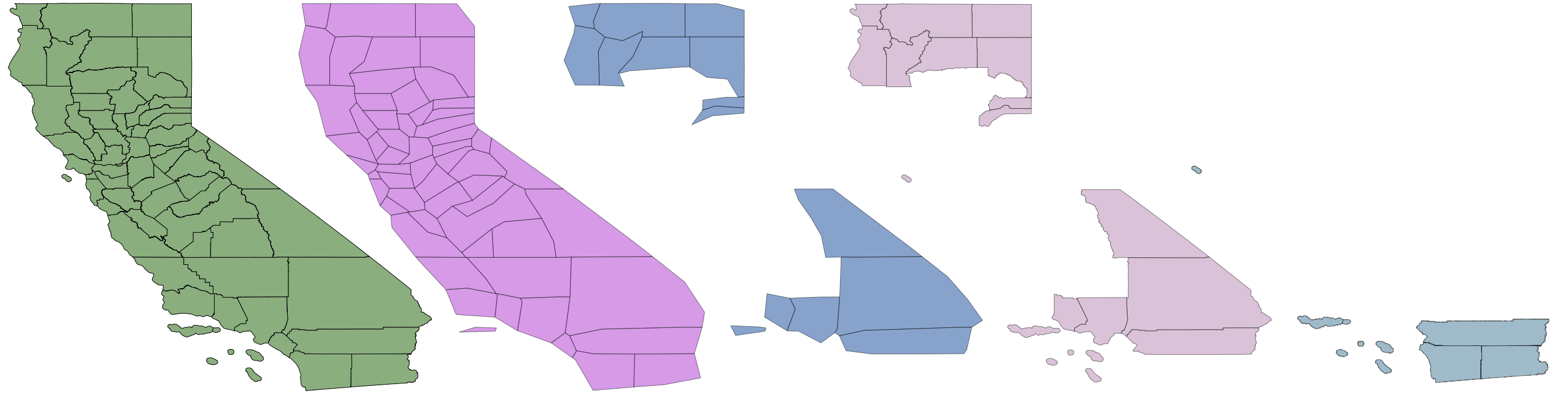

I’m a brand new user to GIS - my goal right now is to heavily simplify Tiger 2010 county and distrct data, without producing gaps between boundaries.
I’ve been testing this with v.generalize in grass via QuantumGIS - I’ve had tons of issues with the Grass toolbox crashing, but have narrowed down to using the Hermite algorithm. While it works, I’m having some bizarre issues with it. Apologies for the cross-post with the PostGIS mailing list.
In the attached gif of California counties, from left to right, I have used the following tolerance values with the Hermite algorithm:
  • original
  • 1.0
  • 0.08
  • 0.01
  • 0.00001
Why do counties disappear entirely as I decrease the tolerance?
In the Grass Tools I choose the v.generalize function. I choose Boundary as the feature type (though I’ve tried checking others, as well as all of them and it doesn’t seem to change anything). Everything else is default, except for tolerance as notated above.
When I tested this originally on only Arkansas and Mississippi, I got really nice results. I then tried it on the entire US and had the missing counties problem. So I tried only California, and still have the same issue.
I’ve tried other algorithms, but this has so far given me the detail I want - of course sans counties! Any thoughts?
Thanks,
  • Chris
This problem has been fixed in GRASS 6.4 only 2 weeks ago (June 13).
Please update your GRASS version if possible.
Markus M

On Thu, Jun 30, 2011 at 4:47 PM, Christian Guirreri
<christian@guirreri.com> wrote:
I'm on GRASS 6.4.1. QGIS 1.7.0
In this version, v.generalize is still broken. You would need a recent
version of GRASS 6.4.2. For Windows, you can get a recent version
here:
http://wingrass.fsv.cvut.cz/grass64/
Markus M

Success! Thanks for making this easy for the total noob that I am.

Markus M
On Thu, Jun 30, 2011 at 10:18 AM, Markus Metz
<markus.metz.giswork@googlemail.com> wrote:
On Thu, Jun 30, 2011 at 4:01 PM, Christian Guirreri
Tiger
had
to
issues
used
  • original
  • 1.0
  • 0.08
  • 0.01
  • 0.00001
Markus M
as
them
except
really
counties
want
  • of course sans counties! Any thoughts?
Thanks,
  • Chris
grass-user mailing list
grass-user@lists.osgeo.org
http://lists.osgeo.org/mailman/listinfo/grass-user
On Thu, Jun 30, 2011 at 7:49 PM, Christian Guirreri <guirreri@gmail.com> wrote:
I suppose my other question is if anyone has any recommendations concerning
v.generalize as it applies specifically to tiger data - I'm doing all of US.
Lots of settings and tests and its a bit overwhelming for a newbie.
For simplification (vertex reduction), Douglas-Peucker is generally a
good choice, it's relatively simple and commonly used.
For smoothing, Chaiken's Algorithm and Hermite Interpolation should
produce quite different results, apart from being a matter of taste,
it depends on what kind of modifications are allowed.
Markus M
