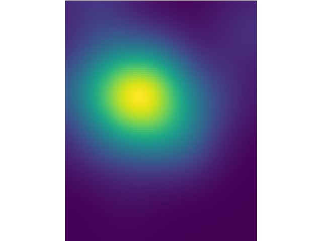

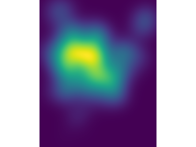

Hi Taïs
Thanks for testing.
As Moritz mentioned, the important parameter in spatial kernel density is the bandwidth.
Here attached is an improved script that uses the spatialEco R package (instead of density.ppp from spatstat). To run this, you’ll need to install spatialEco in your R environment.
This package allows to specify both the bandwidth and the target raster extents and resolution. In this script I take the extents and resolution from the GRASS region. Bandwidth is specified on the command line.
So to try this, in your running GRASS session:
Rscript kernel_density.R
I also attached two images in a test I did, with bandwidths of 10,000 and 20,000.
Hope this helps,
Micha
(attachments)
kernel_density.R (2.03 KB)
Hope this helps,
Micha
