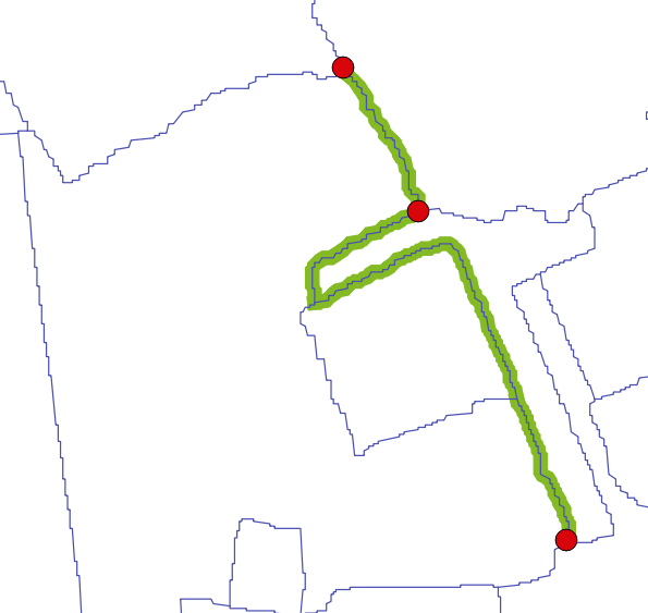

The result looks the following connecting the 3 nodes via the line layer.
