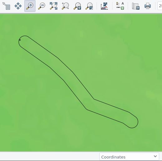

the original vector map is this:
Map format: native
Type of map: vector (level: 2)
Number of points: 0 Number of centroids: 1
Number of lines: 0 Number of boundaries: 198
Number of areas: 1 Number of islands: 1
Map is 3D: No
Number of dblinks: 0
So, it seems that my area (boundaries) disappear during the conversion…
