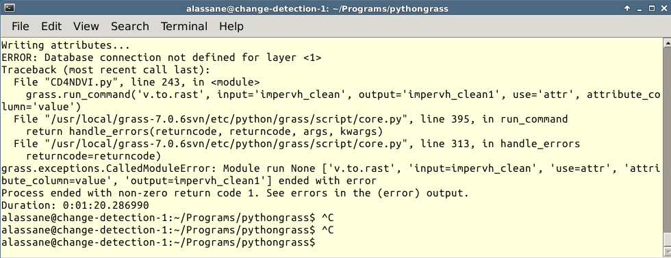

While executing v.to.rast the following error came up (not present in earlier 7.0 version)
Inline image 3
Your suggestion is appreciated.

Check your database connection for the input vector, it says:
"Database connection not defined for layer <1>"
using v.db.connect -p vector_name
Anna

I run the command you suggested and there is indeed a connection problem. How do i fix it? Here are the commands i run in a grass/python script:
criteria=“(value=255) and (area_sf>”+sys.argv[5]+“)”
grass.run_command(‘v.extract’, input=‘imperv’, output=‘impervh_clean’,type=‘area’,where=criteria)
Here is the command yielding the database connection error…
grass.run_command(‘v.to.rast’, input=‘impervh_clean’, output=‘impervh_clean1’,use=‘attr’,attribute_column=‘value’)
Any suggestion to establish db connection for vector map “impervh_clean”?

That's hard to say from this, check whether the v.extract gives any
warning and if it extracts any features.

correct. there was no feature in “impervh_clean” !
