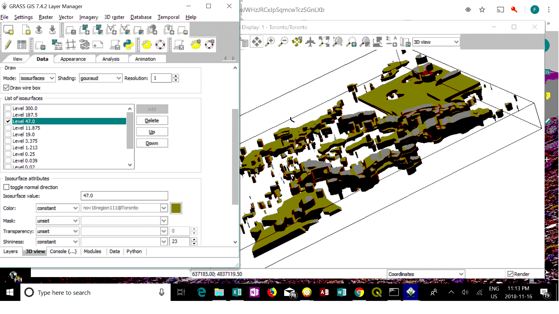

On 14/11/18 01:28, Francois Chartier wrote:
Hi,
v.vol.rst starts working when npmin is 100 m or more. I dont believe that this algorythm only works with data points spaced by 100 m that does not make sense. is there a max total number for a dataset? is it because i have too few rows and columns?
see metadata below. i also showed a lower dmin of 0.9. g.region is printed at the end of the email
Your g.region output does not correspond to the region that was set when you ran v.vol.rst as the map created has a resolution of 500 in x and y direction, but your region says 10.
Could you provide the output of g.region -p3 to also get the 3D settings ?
I don't have an exact idea, but the map you created has a resolution of 500 x 500 x 176, so maybe if you have a point per meter this just means that the number of points you have per target pixel is much too high.
Maybe you need to think about the appropriate 3D region first and make sure to set that before running v.vol.rst ?
Moritz

So i rerun v.vol.rst with new g.region -p3
C:>g.region -p3
projection: 1 (UTM)
zone: 17
datum: nad83
ellipsoid: grs80
north: 4862000
south: 4825700
west: 609200
east: 651700
top: 250.00000000
bottom: 50.00000000
nsres: 10
nsres3: 504.16666667
ewres: 10
ewres3: 500
tbres: 1
rows: 3630
rows3: 72
cols: 4250
cols3: 85
depths: 200
cells: 15427500
cells3: 1224000
V.VOL.RST run (below) with increasing DMIN, from 0.5 to 200. finally worked with 200 m of min spacing. as you can see the majority of the points are excluded.
I am using 180k points over a 40 km 40 km domain.
I have not set any smoothing parameters. also using the default tension parameters and as data points are very close vertically (every m or less)
Thanks
(Wed Nov 14 20:50:41 2018)
v.vol.rst input=geotechNov8@Toronto wcolumn=dbl_2 segmax=10 npmin=20 npmax=100 dmin=0.5 elevation=geotechnov8nov14
188692 records selected from table
WARNING: Some points outside of region – will ignore…
ERROR: Points are too concentrated – please increase DMIN
(Wed Nov 14 20:50:50 2018) Command finished (8 sec)
(Wed Nov 14 20:51:08 2018)
v.vol.rst input=geotechNov8@Toronto wcolumn=dbl_2 segmax=10 npmin=20 npmax=100 dmin=5 elevation=geotechnov8nov14
(Wed Nov 14 20:51:17 2018) Command finished (8 sec)
(Wed Nov 14 20:51:25 2018)
v.vol.rst input=geotechNov8@Toronto wcolumn=dbl_2 segmax=10 npmin=20 npmax=100 dmin=20 elevation=geotechnov8nov14
(Wed Nov 14 20:51:34 2018) Command finished (8 sec)
(Wed Nov 14 20:51:46 2018)
v.vol.rst input=geotechNov8@Toronto wcolumn=dbl_2 segmax=10 npmin=20 npmax=100 dmin=50 elevation=geotechnov8nov14
(Wed Nov 14 20:51:59 2018) Command finished (12 sec)
(Wed Nov 14 20:52:11 2018)
v.vol.rst input=geotechNov8@Toronto wcolumn=dbl_2 segmax=10 npmin=20 npmax=100 dmin=70 elevation=geotechnov8nov14
(Wed Nov 14 20:52:20 2018) Command finished (8 sec)
(Wed Nov 14 20:55:19 2018)
v.vol.rst input=geotechNov8@Toronto wcolumn=dbl_2 segmax=10 npmin=20 npmax=100 dmin=100 elevation=geotechnov8nov14
(Wed Nov 14 20:55:28 2018) Command finished (8 sec)
(Wed Nov 14 20:55:46 2018)
v.vol.rst input=geotechNov8@Toronto wcolumn=dbl_2 segmax=10 npmin=20 npmax=100 dmin=200 elevation=geotechnov8nov14
Processing all selected output files will require 24480 bytes of disk space for temp files
WARNING: There are points outside specified 2D/3D region–ignored 3533 points (total points: 188692)
WARNING: Points are more dense than specified ‘DMIN’–ignored 175580 points (remain 13112)
WARNING: Unable to create <(null)> raster map without cross_input raster map being specified
Finished interpolating
3D raster map created
The number of points in vector map is 188692
The number of points outside of 2D/3D region 3533
The number of points used (after reduction) is 9579
(Wed Nov 14 20:55:58 2018) Command finished (12 sec)

Finally. I am was able to make v.vol.rst work.
How it worked.
I made the resolution to be 1 m in the 3 directions, x,y,z directions with g.region.
I thought that perhaps due to the high density of points perhaps i needed to increase the resolution.
Below I am viewing the data with Isosurface with the 3d viewer, under
View tab->3D raster, → choose 3d raster → add isosurface, define the interval you want to see, and color set as constant (i used bgyr as the color, but everything turns out blue…).
Virus-free. www.avast.com

Hourrah Finally. I am was able to make v.vol.rst work.
How it worked.
Now the work begins.
attached I am viewing the data with Isosurface with the 3d viewer, under
How it worked.
I am viewing the data with Isosurface with the 3d viewer, under (cant forward image as too large for mail list)
THANK YOU for your help. will keep u posted on progress.
