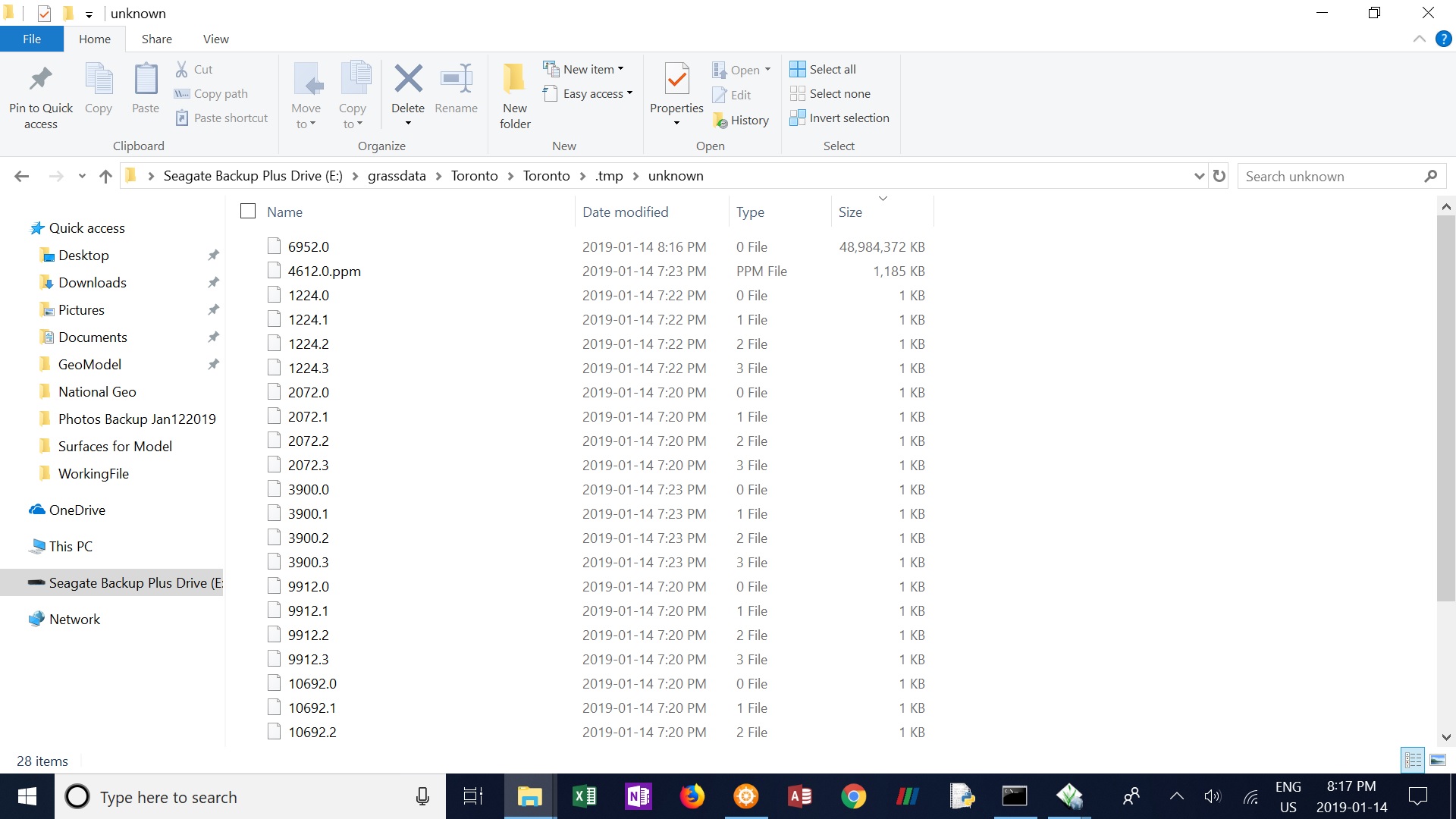

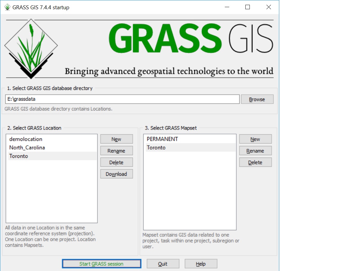

grass data is on the external drive, see screenshot attached.
freespace on external drive 1.77TB
what is interesting with the external drive is the temp file does not really explode in size like if files are on laptop:
it has been running for about 50 min now.

So I copied all the grass data file onto an external hard drive with 1 Terabyte of space. started grass and browsed to the data that is
saved on the external hard drive. when running vvolrst, the process also crashed due to not enough space…
the memory situation is much better during the process.
for some reason it does not seem to increase the size of the temp file on the hard drive…
So the grassdata directory with the location and mapset in question is
on the terabyte disk?

it finally finished the process. the files size that was created on the external disk was 50GB as you can see on the attached screenshot.
the interpolation took 49 min to complete.
I changed the region, made the domain slightly smaller and used a lower resolution:100x100x5
g.region

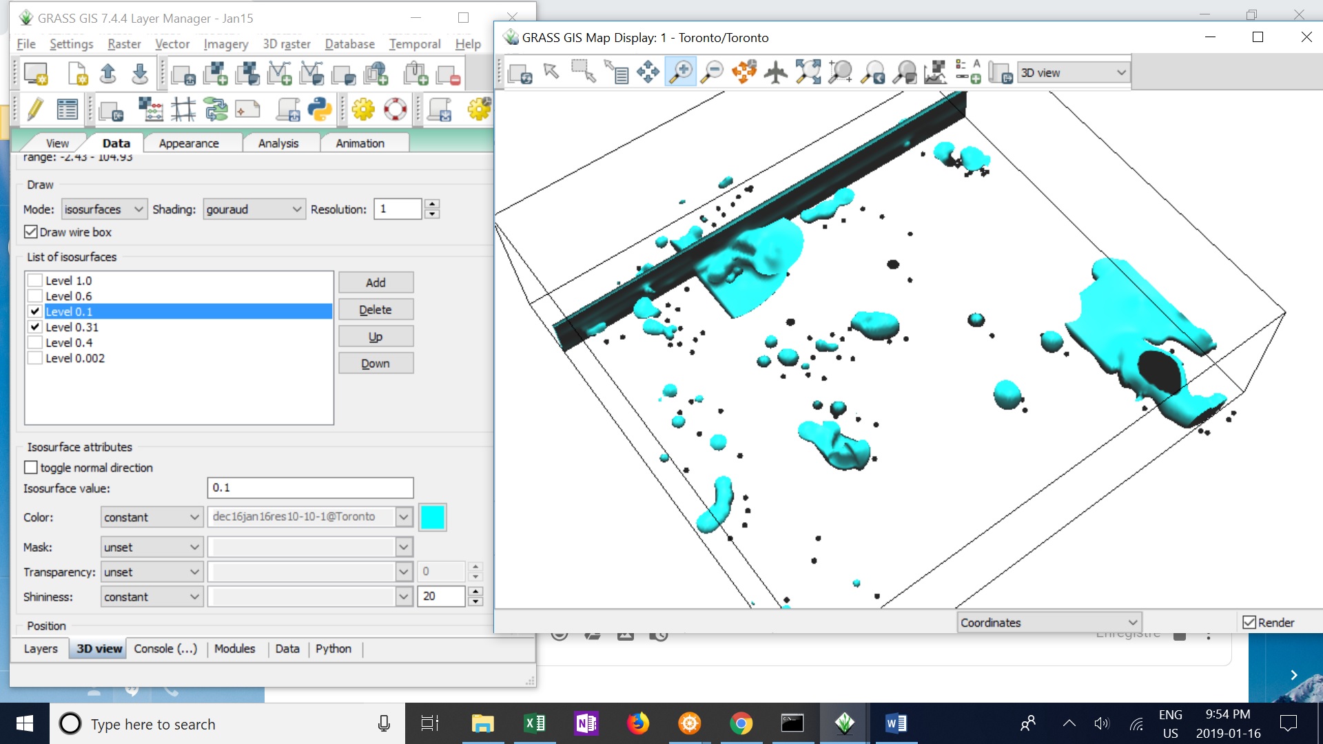

is there anyway to remove the shade in the 3D view ?
Under the "Appearance" tab you find
Lighting for adjusting light source
Markus
I think the problem came from my g.region setting. under the resolution tab i was only filling for example EW, NS and vertical. then i noticed that the 3d resolution was different when printing g.region and i was creating for ex in the order of 100 million cells. i solved that by setting every cell under the resolution tab, even if that means repeating the same info (perhaps i havent understood something yet), and it works.
for the lighting, i have checked this tab earlier and i recall that u can onlh change the sun position which then results always in a shaded area which impacts 3d isosurfaces.
thx
