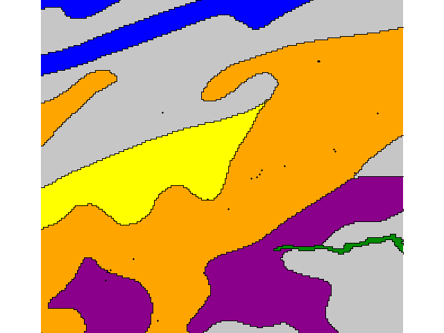

interpolation? I've attached a small section of my map, so you can see
that the individual points are placed within large polygons, so I
don't think there's a chance that I'm clicking in a different polygon
than the one the point is in.

Thanks, Micha.
I figured it out. I had incorrectly connected the database table to the map. The table had multiple key values for each polygon.
The dataset is the Harmonized World Soils Database. I've updated the wiki with correct instructions. I think they're correct, at least.
