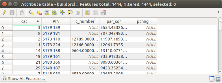

Dear Moritz & group,
I am a newbi in python programming. Following Moritz’s instructions i added the followings…
par_sqf=
c_number=
pchng=
but pchng stayed NULL for all rows (see below)!
Inline image 2
Any suggestions how to resolve this?

Hei Alassane,
Can't you just do:
db.execute sql="UPDATE parcel SET pchng=int((0.25*c_number/par_sqf)*100)"
Cheers,
Stefan

It works great…thanks Stefan!

Dear Alassane,
Please keep conversations on the list.
On 29/08/16 19:49, alassane toure wrote:
Dear Moritz,
I am a newbi in python programming. Following your instructions i added
the followings..
par_sqf=
c_number=
pchng=
You set pchng = range(len(par_sqf)),
but par_sqf is only defined as a Python variable by
par_sqf=
so it is normal that it is NULL.
Don't mix up Python variables and vector map column names.
If you want to set the attribute column pchng to contain a value that is equal to the length of the value of the attribute column par_sqf (i.e. count the number of digits (plus decimal point) in the area value), then you have to use v.db.update:
v.db.update map=parcel column=pchng qcol="length(par_sqf)"
Although I don't understand what the sens of such a length would be.
Maybe it would be easier if you explained us what you are trying to do, instead of only how you are doing it.
Moritz
Problem solved! Suggestion was made to use db.execute and it worked without variable declaration. Thanks for your insight!
