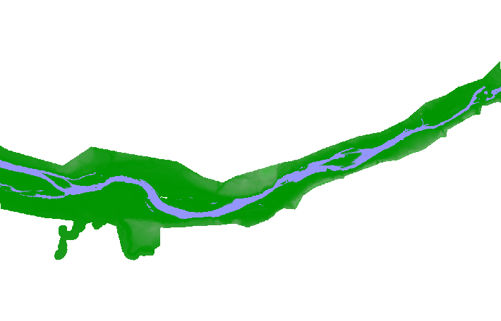

I've a raster bathymetric map (attached) to which I've applied r.color =
'elevation' because I didn't see another style more appropriate for aquatic
environments. I'm sure there is at least one in various shades of blue and
I'd like suggestions for what to use or do to create one.
Also, is there a way to get narrower depth slices since the riverbed is
comparatively shallow and flat in this data set.
BTW, I sent a request to the appropriate data source for the name of the
most appropriate terrestrial LiDAR data set for the north side of this
river.
Er, forgot to attach the map. It's on this one.
Mea culpa!

I'd try 'water' or 'etopo2'.

Your data looks continuous, so what do you mean by "slices" ? A continuous color table doesn't have slices.
The data are continous. What I meant by 'slices' is smaller ranges between
colors so finer depth increments can be seen.

The etopo2 color set is perfect for these data (attached). It displays the
thalweg (depest channel in the river with the fastest current velocities) as
well as the shallower areas aganst the banks.

Hi! you can try ‘water’ with an histogram equalization (e flag)

It turns out that for this data set r.colors -en provide the most
informative view of the river's bathymetry along this long reach (see
attached).
