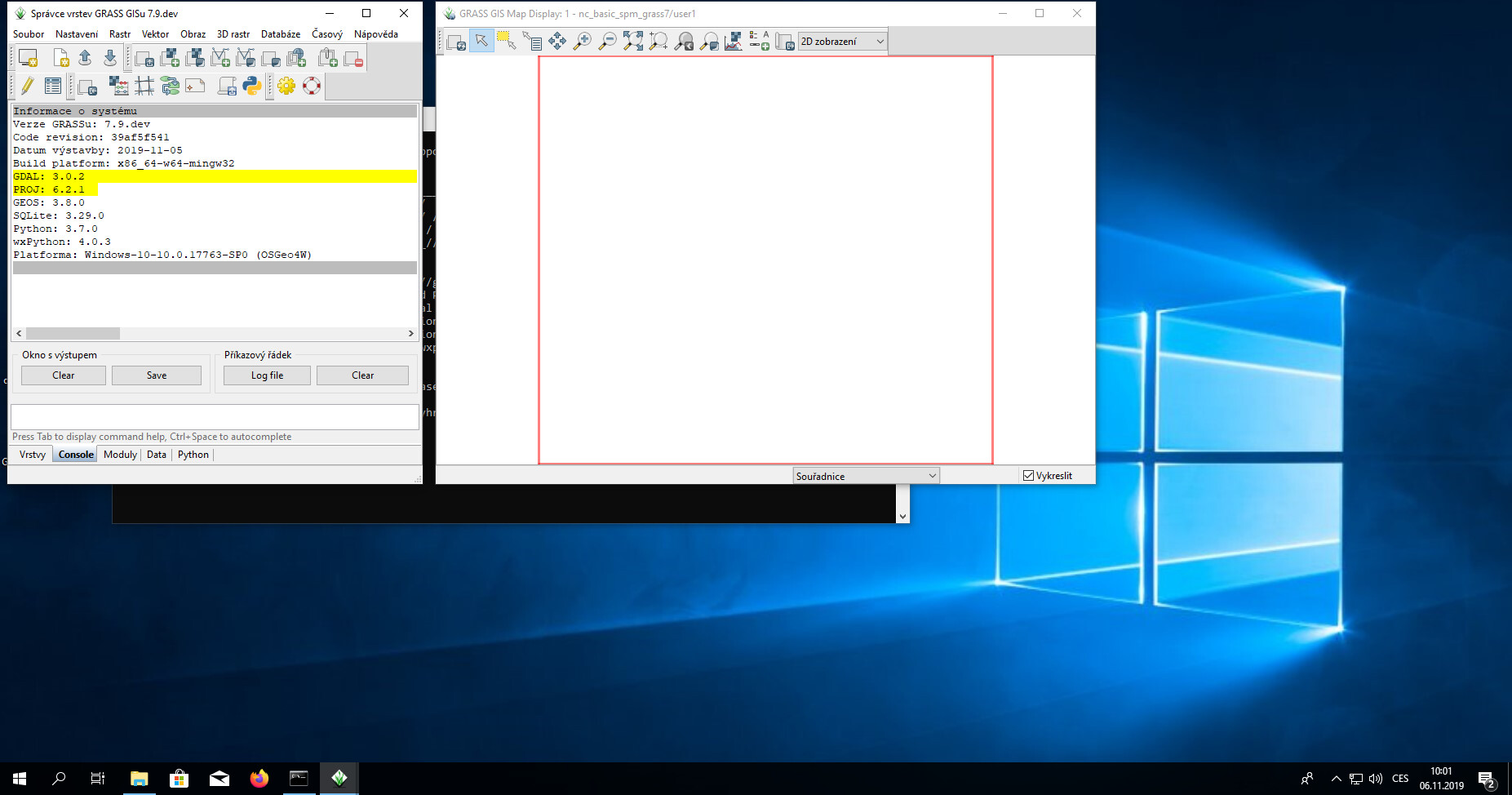

Hi,
út 5. 11. 2019 v 20:31 odesílatel Helmut Kudrnovsky <hellik@web.de> napsal:
I could do a test compilation with OSGeo4W testing/experimental mode and issue a
grass-7.8.1RC1-2.tar.bz2
with test in setup.hint.
not sure how ready Martin's build environment is to switch also to build addons ?!
next daily builds (32/64bit) should be built against GDAL3/PROJ6.
We are close 7.8.RC2, BTW.
Ma

Hi,
st 6. 11. 2019 v 9:42 odesílatel Helmut Kudrnovsky <hellik@web.de> napsal:
daily builds with proj6/gdal3 in OSGeo4W looks good so far.
yes, screenshot attached. Let's wait for RC2. Ma
