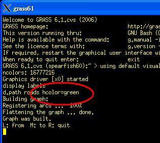

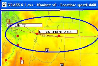

I find the wrong highlight color of shortest path, when I run shortest path(visualization) (i.e. Vector-> Network Analysis-> shortest route(visualization).
I am using GRASS 6.1.cvs obtained from http://geni.ath.cx/grass.html#toc5.
If I don’t specify the color parameter(hcolor), the default is red; however, it displays black color. When I specifiy the color(hcolor) to be green, it displays red(as screen dumps attached). Do you have the same problem? Is it bug for the GRASS?

It's a bug; d.path is trying to set the colours while not connected to
the monitor.
I'll look into this.

Fixed in CVS.
