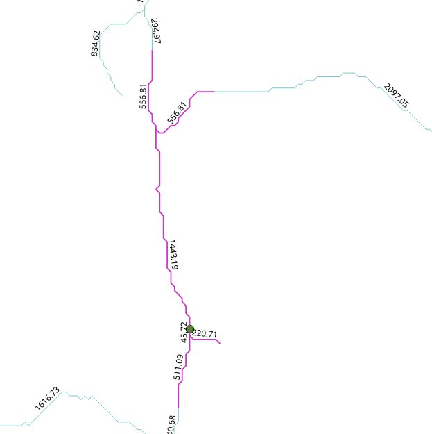

I am using v.net.iso to split a stream network at a certain distance from sampling points.
First, I create a network from vector lines (streams) and vector points (sampling sites) using v.net. The lines feature have a 'cat' column, 'length', 'backward_cost' and 'forward_cost'. I would use -1 for forward costs because I am only interested in the upstream part, and length for backward costs in v.net.iso:
v.net.iso input=test_edges arc_layer=2 node_layer=3 output=test_edges_bw_2000 center_cats=55 arc_column=forw_cost arc_backward_column=backw_cost costs=2000
However, the backward part of the resulting lines with cat 1 is always too short. Likewise, if I give just 1 for the backward costs and set the costs to 5, it gets 4 segments with cat 1. Working in both directions at the same time gives correct values for the forward end, but too short for the backward end. I then realised that the numbers would be correct if the first part of the forward end was added to the backward part (see attached example). The forward part all the costs (lengths) sum up correctly to 2000 (1443.19 + 556.81). For the backward part it would be 45.72 + 511.09 = 556.81. However, if the first segment of the forward part is added, it gives the correct cost sum (45.72 + 511.09 + 1443.19 = 2000).

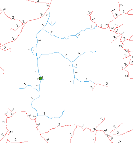

I just realized that it works correctly for length in both direction if the parameters arc_column and arc_backward_column are not given. However, for me this is inefficient because I only need the backward end.

For the record in the ml, the problem was that several lines had the same category, thus uploaded lengths for each category were the sum of all lines with that category. The problem was solved by creating a new layer and adding unique categories for lines to that layer. This new layer was then used as arc_layer.
