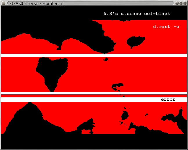

I have a raster created with 5.7's 'v.to.rast use=val val=123.4'. When
viewed with d.rast in 5.3 or 5.7 and zooming in, it displays incorrectly
(white band) on raster rows containing all the same value.
(r.colors col=rules < 0% red ; 100% red)
d.what.rast gives the correct answer both in & out of the band.
running [in 5.3 now]:
(test1 is the bad version [DCELL])
r.mapcalc test2="float(test1)"
this makes a new FCELL raster which displays properly.
converting this back to DCELL with double() produces a good raster.
but if I run:
r.mapcalc test3=test1
I get a new DCELL raster which still has the problem.
Is v.to.rast writing bad files? is the error limited to the display?

I seem to remember seeing this sometime in the past, just ran across it
again today.
.. the percentage part of r.colors seems to be the culprit:
r.info:
Data Type: DCELL
Range of data: min = 177.700000 max = 177.700000
r.colors col=rules
Enter rules, "end" when done, "help" if you need it.
fp: Data range is 177.6999999999999886313162278 to 177.6999999999999886313162278
0% red
100% red
end
If I set the rules to
170 red
180 red
end
it displays fine.
