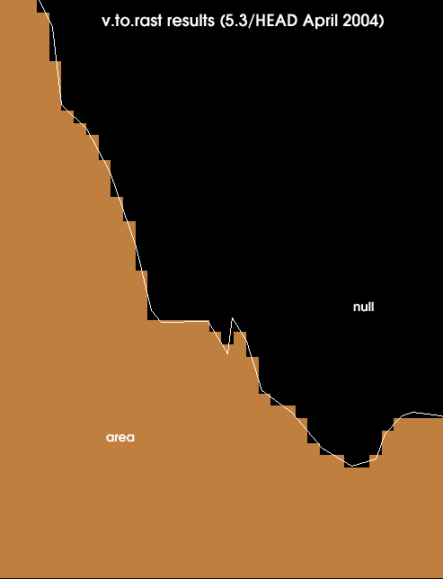

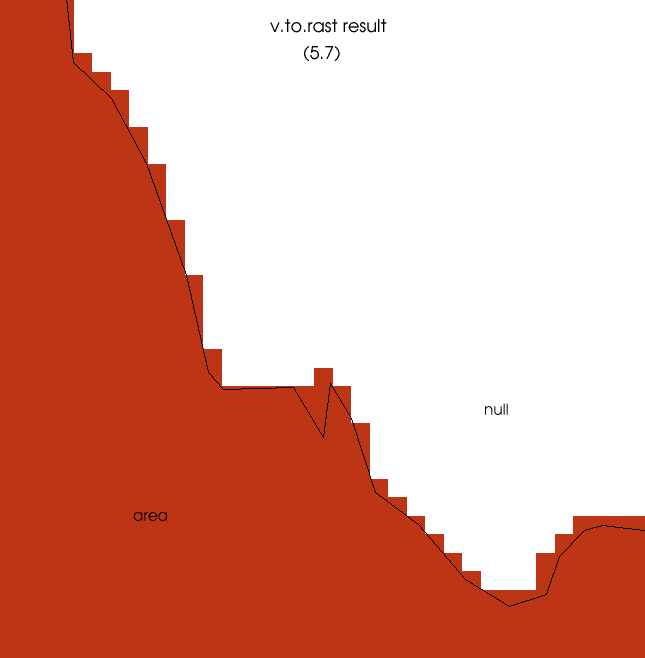

I'm having another try at this and it appears the problem goes away if I
export the vector file to 5.3 (& run v.alabel and v.support). This
solves my immediate problem.
I'm not sure at this point what I was doing to make it show up in 5.0 &
5.3 before or if I was mistaken or something else is different now.
Maybe the date had something to do with it.
Trying with 5.7 from last week still produces bad results.
see attached before & after pics. v2rast_1.png is using 5.7's v.to.rast,
v2rast_3.png is using 5.3's version.
Can someone confirm? Is this a 5.7 vector bug?
Hamish

Yes, that's it.
Running v.to.rast on a v.in.ascii + 'v.support -r' [5.3] file without
any Category info you get no output.
(a) After running v.alabel on that, you get what I was aiming for, i.e.
output raster straddles the boundary line.
(b) After running v.alabel + v.llabel on that, you end up with what I
was getting, a "hull" of the vector file.
(c) If you only run v.llabel on the vector, you will get a raster line
which straddles the boundary line.
Note c != patch(a,b) !!
so I guess it's a feature, not a bug, but not terribly intuitive ...?
If this is in fact the expected behavior, the man pages should be
updated to include this info.
Hamish
I've just changed the v.to.rast man pages to document this, but after
some more experimentation I'm more convinced that there's a bug in the
5.7 version.
quoting my additions:
http://freegis.org/cgi-bin/viewcvs.cgi/*checkout*/grass51/vector/v.to.rast/description.html
[... only labeled items will be converted]
# Labeled areas and/or centroids will produce filled raster coverages
  with edges that straddle the original area boundary **as long as the
  boundary is NOT labeled**.
  (Use v.category option=del type=boundary to remove.)
# Labeled lines and boundaries will produce lines of raster cells which
  touch the original vector line. This tends to be more aggressive than
  area-only conversions.
# Points and orphaned centroids will be converted into single cells on
  the resultant raster map.
Specifically, lines will not know which side is in or out so they must
tag all cells they pass through for any significant distance. Boundaries
on the other hand should know which side is in/out and only tag cells
whose center points are inside the area. Currently boundary->raster
conversions act line line->raster which I think is wrong.
You only see this in 5.3 if you have run v.llabel on a vector containing
area features, and now that it is documented in the help page, no
problem.
Creating a new area with 5.7's v.digit labels the boundary by default so
this pops up a lot more often.
Hamish
Hamish
5.7 version.
I don't think so.
The boundary may represent another linear feature, e.g. area is
forest (field 1) boundary is road (field 2), then
v.to.rast field=2 must create linear feature.
problem.
Then it is problem in v.digit not in v.to.rast.
v.digit should remember category setting separate for each line type
and it should set "No category" as default for boundary.
Radim
