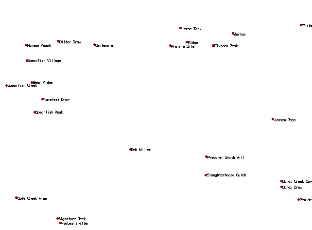

I just did a test with the new gis.m and attach 3 small files here. In two
cases (making the eps and pdf), I used the print function dialog. In the
third case (making a png), I used the save output function.
As you can see, there are labels in all 3 images.
Michael

Dear Michael,
In d.m and gis.m, there is a radio button for showing labels, you
choose what column to display and its parameters, left, right, size,
etc. Does this make a temorary label file for display? I was guessing
that it was somehow able to draw directly from the database, since
there is no place to specify a label file. This all seems very
intuitive; but when printed to postscript, those labels do not appear
(for me at least; because I don't have ghostscript, perhaps?). So
I've been working through ps.map; which works fine, but involves the
extra step of creating a label file. The postscript from ps.map comes
out as proper editable text, not as a raster, which is important to
me as I'll need to move the labels around later. Creating the label
file is not much of a hassle, except that it requires knowing in
advance how large the labels should be; you can't resize them on the
fly and immediately see what the results are. I just wondered whether
a more direct method was in store for the future.

Yes, I'm talking about the quick-and-dirty display labels from d.vect. These are incredibly useful, as you point out, and again, very intuitive; they are an attribute of the vector file rather than some separate file which you have to remember about. Thank you for the test images. However, as you point out, they are bitmaps; and I'm looking for postscript output which will allow me to move and edit the labels for a published map. Ps.map does that just fine. I would still wish that ps.map could draw directly on the vector attributes for drawing labels, like gis.m and g.m do, rather than going through an external label file.

GMT can do things like this... although it requires a bit of pre-processing of
the data.
Dylan
Best wishes,
Nick
> In two
> In the
> Michael

The text layer in the new GIS Manager (start with gis.m&) is drawn by the
TclTk canvas so that it is postscript text in eps output. So it might be
what you are looking for. However, it is only for single labels, manually
placed.
Michael

I see that you are talking about the display labels created by
d.vect--rather than those created by d.labels.
The d.vect labels are a 'quick and dirty' vector labeler, but that is
exactly what is needed at times.
In two
In the
Michael
