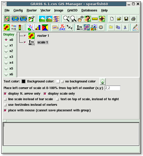

  1. Finally, the GIS manager itself seems to be missing some drop down menus and features- i am attaching a creenshot of the GIS manager:

4. Finally, the GIS manager itself seems to be missing some drop down
?what's missing?
again, you wil have more luck with Francesco's GRASS 6.1-cvs packages
from DebianGIS vs. the generic binaries.
