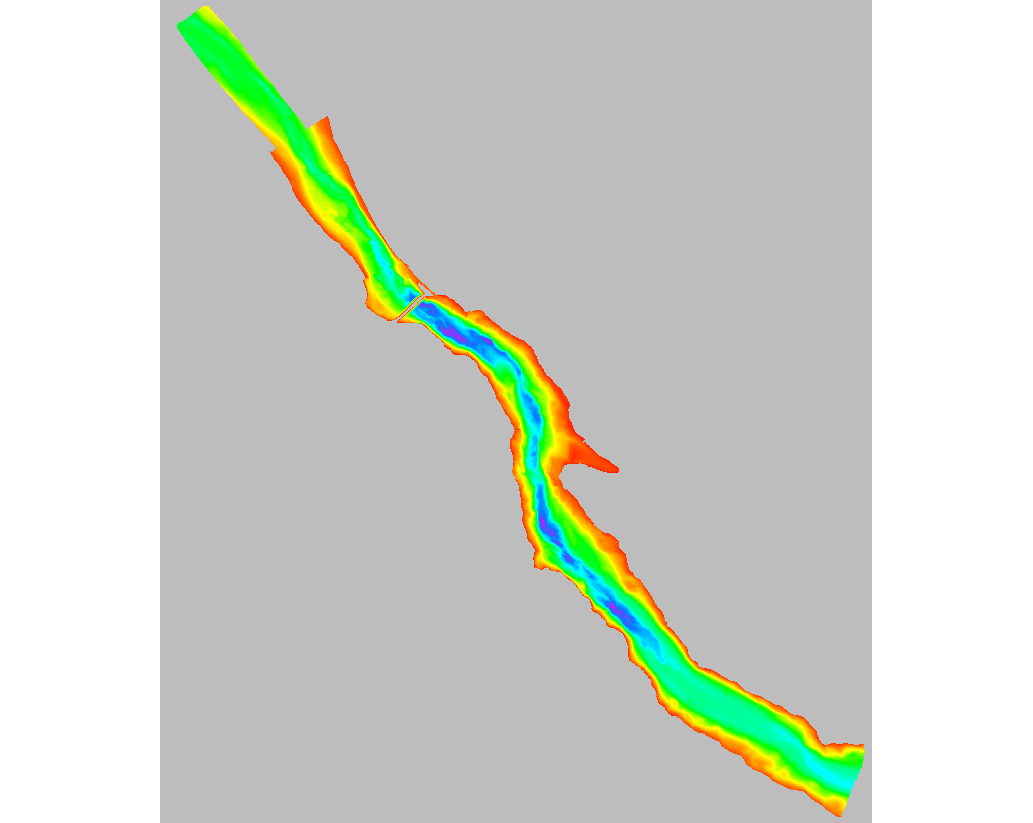

Ok, I'll try to explain what I mean. I have certain bathyemtry rasters that
are pretty unusual in shape - see attached - this map pretty much maximizes
the null/data ratio for the given region which completely encloses it's
shape. So I have a couple questions:
The first question is to clarify my understanding of how nulls are
represented in Grass rasters.
1) Does an increase in the number of null cells within a region increase the
raster's file size on disk? If I increase the region 2x in both N-S and E-W
dimensions, but add no valid data only null values, I'm getting a bigger
raster regardless, correct?
2) If (1) is true, then can a raster such as the one in the attached image
be made smaller by tiling together a number of smaller regions that only
cover the areas with data? Or will the patched product of these smaller maps
only approximate (very closely) the total size of the original raster?
So, to sum in one sentence, I want to make a big diagonally-shaped raster
smaller by cheating and making a bunch or smaller maps that cover data areas
only (and subsequently have low null content) then patching the smaller ones
together. But I'm worried that this whole process just puts Humpty back
together again and I'm left with just as many nulls to data as I started
with.
Correct. Although increases in horizontal resolution won't necessarily
produce proportional increases in file size, due to compression.
Increases in vertical resolution will.
with.
Your understanding is correct.
that are pretty unusual in shape - see attached - this map pretty much
maximizes the null/data ratio for the given region which completely
encloses it's shape. So I have a couple questions:
Note CELL maps will be smaller than FCELL maps, which will be smaller
than DCELL maps. (ie int,float,double)
Glynn may correct me here, but IIRC, CELL maps with negative values will
be a fair size bigger than CELL maps without negative values, which is
something to consider when storing bathymetry data. By multiplying by -1
in r.mapcalc you may make the stored map size much smaller. This isn't
the case for FCELL & DCELL.

alt: write a script to save the region details (write a world file),
r.to.vect the cells, save only the non-null cells and maybe export to a
text file for gzipping. reverse to recover.
alt2: r.out.ascii or r.out.bin and Bzip2
It's just a matter of what's the least work I think.
