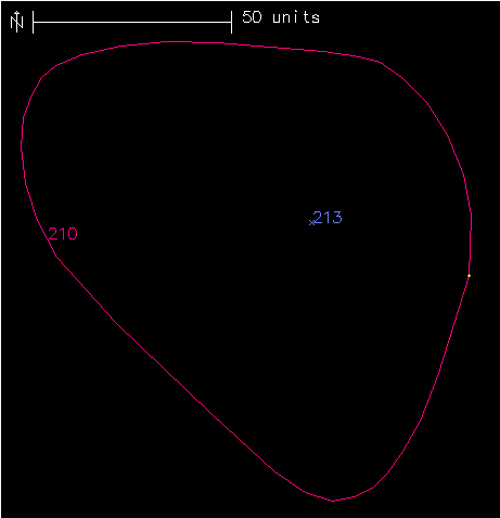

here are two more pictures to see how is the node located (YELLOW on
vdigit.png) in respect to the v.to.sites result (WHITE sites on the
dsitesdvect.png)
